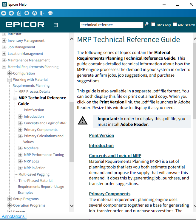

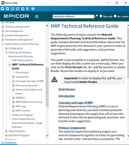

Do you have any guidance book or process to run the whole process?
Because there are various open sales order for which the unfirm jobs are not getting created.
You’ll find the MRP and Scheduling guides in Epicor Help:
