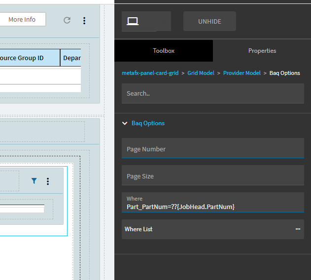

I have some panels bound to a BAQ and using a where clause and also the where list for multiple filters seems to be working ok without a slide out happening like you mentioned in the parameters.
It is under Grid Model → Provider Model → Baq Options → Where List
For each parameter you had set put in Add a column condition and value.
If it is just a single item like the Cust ID then just use teh Where like below I have on a BAQ for part info
MIKE! Let me try this.
So you’re saying just add a BAQ option?
My parameter is CustID. That’s not a column in my results… you still think this will work?
@mmcwilliams --your screenshot is not setting a BAQ parameter. You’re just filtering the results of the BAQ using a where clause based on a column in the query.
That’s how I read it too, but I thought Mike was talking about a parameter from the way Mike made it sound.
I can tell it’s a column Mike is filtering.

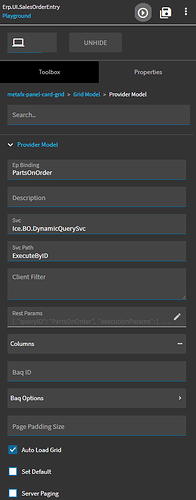

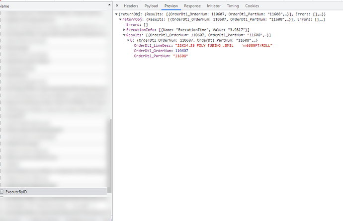

I’m heading out for the day, but here’s where I left off; it’s a step in the right direction.
Rest Params:
	"queryID": "PartsOnOrder",
	"executionParams": {
		"ExecutionParameter": [
				"ParameterID": "OrderNum",
				"ParameterValue": "110607",
				"IsEmpty": "false"

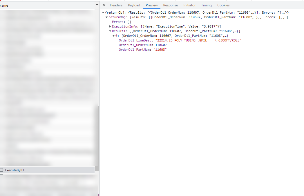

It executes without the parameter slide out appearing.
To Do:
  1. I hard-coded the parameter value. "?{KeyFields.OrderNum}" was giving me an error saying it could not convert from string to int. The JSON requires the field to be a string. Still investigating.
  2. It’s not returning the results to the View I created. Haven’t started looking into this yet.
Figure those out and you have yourself a solution.
Wow. Thank you is not enough. Crazy you got that to work!
I am using the BAQ ID option of the grid’s provider model, I guess this doesn’t work unless I do what you did and use a view?
Not if you want the slide out to not show up.

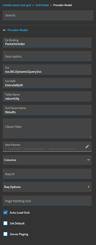

I’m getting closer, but still struggling with the dynamic value.
Rest Params:
				"ParameterValue": "?{OrderHed.OrderNum}"

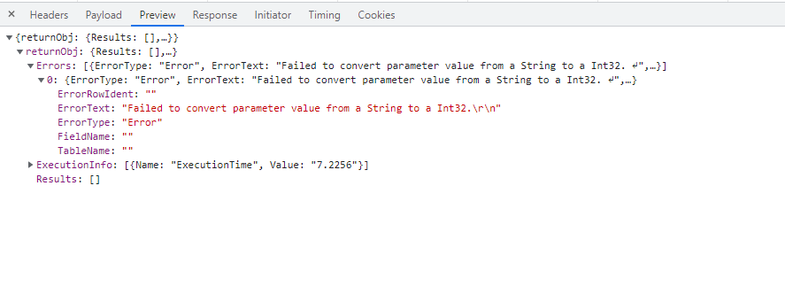

It populates into the view now (I had Results and returnObj swapped).
But it doesn’t seem to want to take a dynamic value. I get the feeling it’s trying to convert “?{OrderHed.OrderNum}” into an int instead of the value of that field.
Is this just how it works? Or is this something we can request as an enhancement?
This is not a gripe.
Yup. At least until enough people complain about it.
I see…
