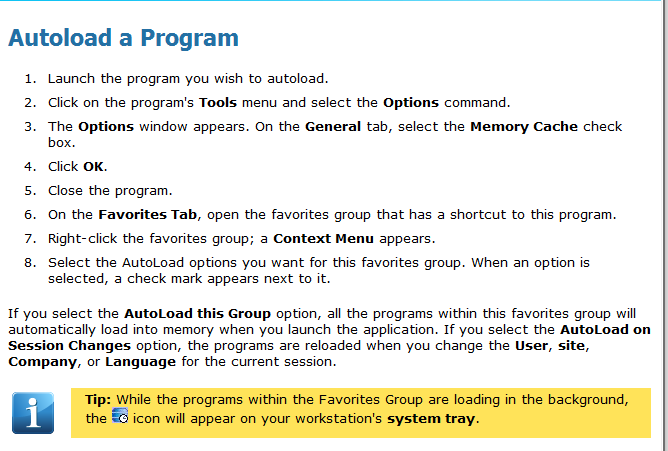

How about using Autoload? Here’s the help on it:
Nancy
