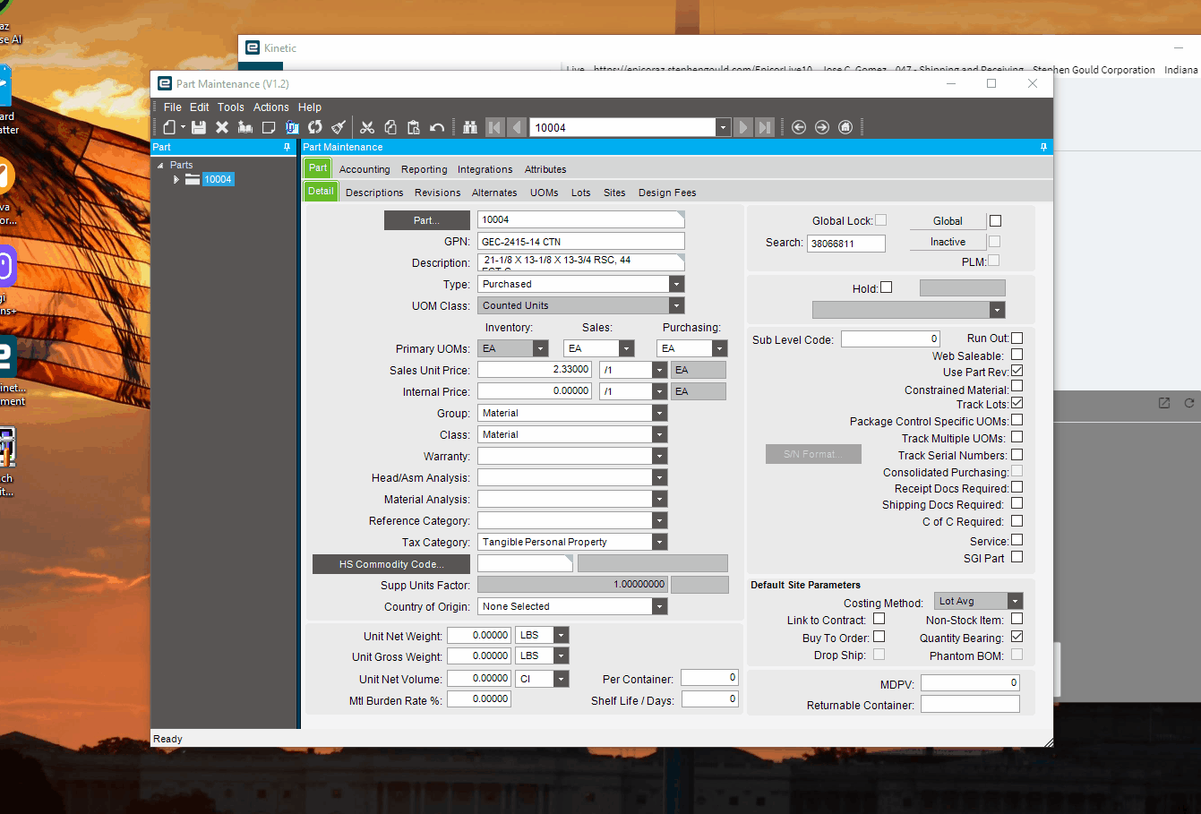

So in Epicor you can send a record to a file by going File → Send Record to File, this generates a file like the one shown below. Which includes a section called “Shortcut” which contains a reference to the record you’d like to launch in the system.
If you pass this file as an argument to Epicor.exe it will use the Session Manager to launch the respective Screen and Record without opening a new Epicor As seen below. So one could write a C# program that can have a template of a record and just dynamically create a sysconfig with the record info and then llaunch the screen.

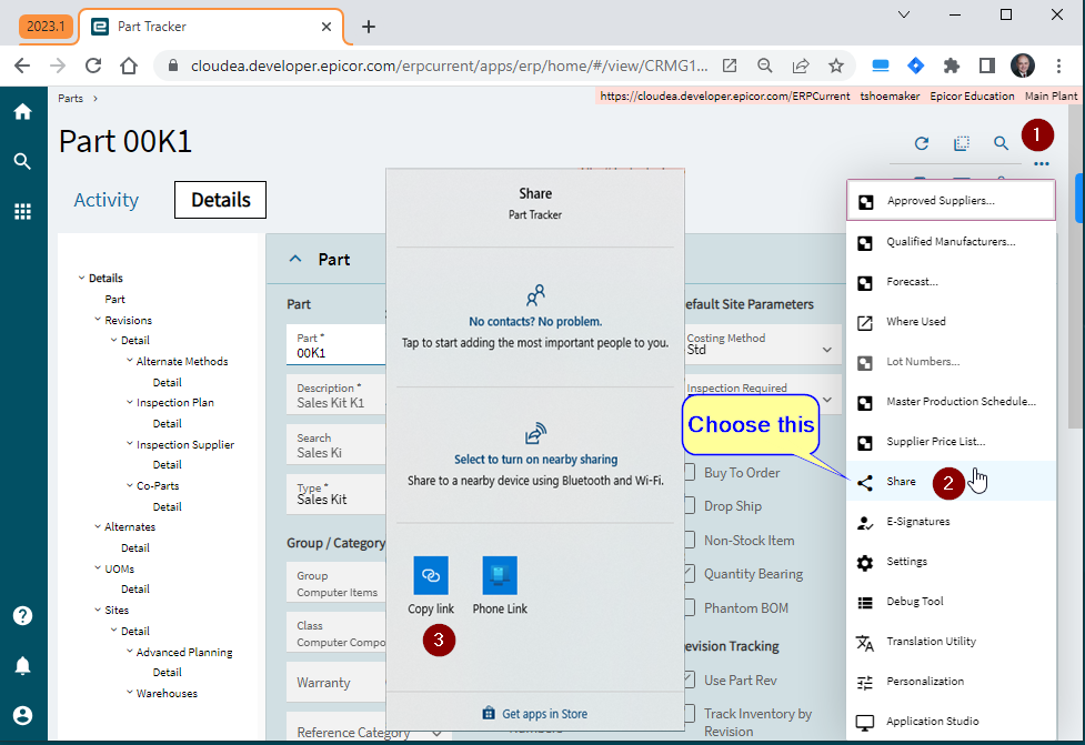

There should be a Share button starting in 2022.
You can do the exact same thing in Kinetic 2023.x generate a URL with a built in record locator

Here is what it looks like to share:
