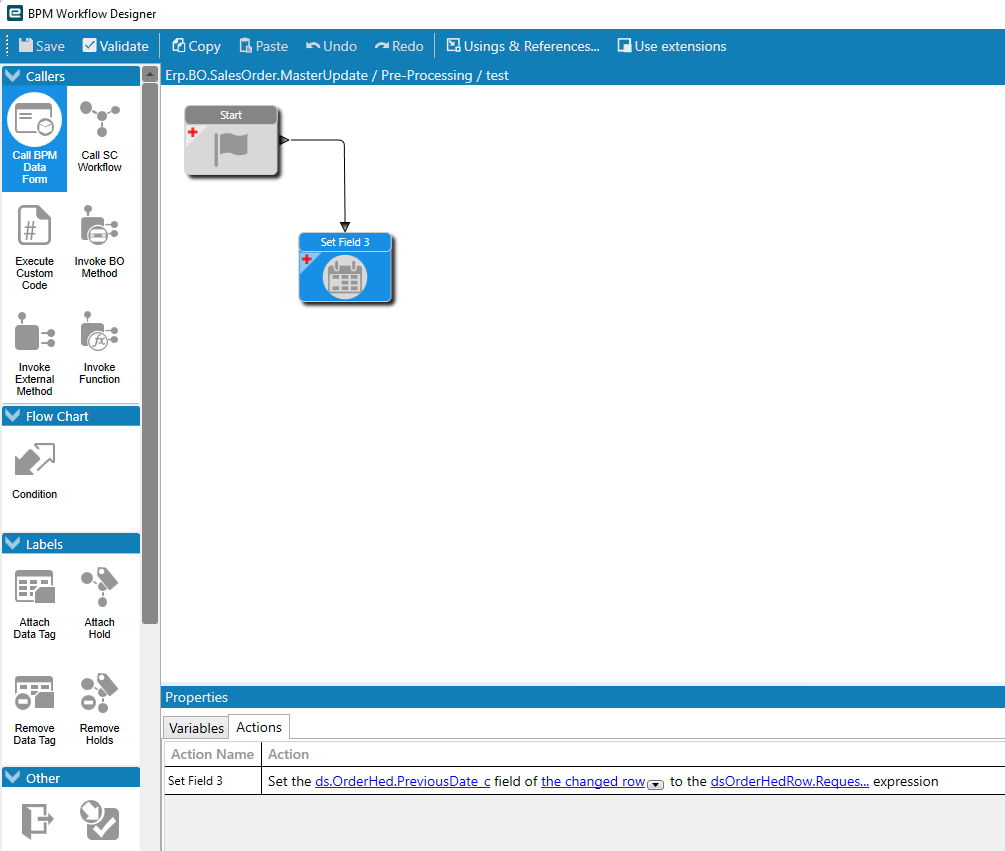

I have created a date UD field on the OrderHed table. The goal is to have this UD field populate with the date in the ShipBy field prior to getting updated via updatable Dashboard. We simply want to retain the date every time it is updated. Started by creating a pre-process method directive on Erp.BO.SalesOrder.MasterUpdate. What I have created only populates the UD field if the OrderHed ShipBy field is null. It will update the UD field then, but from there as the ShipBy date is altered the change is not reflected in the UD field. Any help is much appreciated.

What is the entire expression in your screenshot?
It is enabled.
Expression is dsOrderHedRow.RequestDate

We are multi company, but the scope is set to company specific. Let me retract/clarify what is occurring. Say said date is xx/xx/xxxx, we want that date to populate the UD field. When changing the date to yy/yy/yyyy that same date is being transferred to the UD field upon saving.
At this point, the ttOrderHed.RequestDate is already your new value.
Typically on the “pre-processing” directive, there’s actually two ttOrderHed records in the dataset. One of them is the “original” row which would contain your xx/xx/xxxx date. The RowMod is blank on this row. The other is the row being updated, and this would contain the yy/yy/yyyy date in it; RowMod is “U” on this row.
What you’re doing is setting the UD field of the changed row (the “U”) to the value of RequestDate, which is your changed date. What you really need is a widget that says “set the ds.OrderHed.PreviousDate_c field of the changed row to the dsOrderHedRow.RequestDate of the unchanged row”. Unfortunately, there’s no such widget.
You might be able to accomplish this via the query function. Or, if you know custom code, you could get the ttOrderHedRow that’s original, save the date, then get the ttOrderHedRow that’s being updated and set that date there.

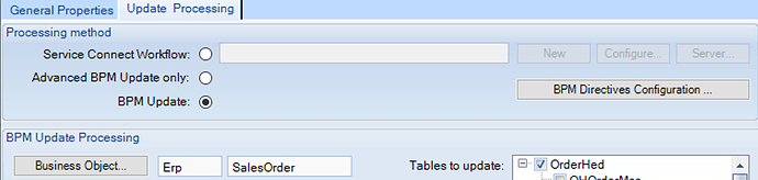

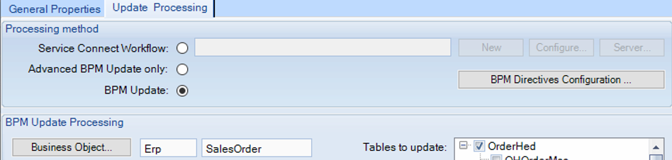

However our goal is to manipulate the RequestDate via updatable dashboard. The BAQ is ran off method UpdateExt. The RequestDate is changed and the BAQ is executed without error, but the PreviousDate_c does not reflect the change, as if the Method Directive is not being fired. My question is more general in what direction do I need to go? Do I need to configure a BPM in BAQ Designer with update method “Advanced BPM Update only” or create a new method directive with method UpdateExt? The code pasted below was attempted on both methods, but only works under MasterUpdate, will it need to be altered for UpdateExt?

You can set the previous date in the ubaq preprocessing on the update.
Epicor only sends the updated rows, so you just need a bit on code or you could do a widget.

Are you inferring to open menu “Updatable BAQ Directives Maintenance” and then choose the Update method under this query?
From there create a new Pre-Process method in designer to invoke the code you posted?
in your updatable baq you have the Update Processing tab and it has a BPM Directive configuration button on the right.

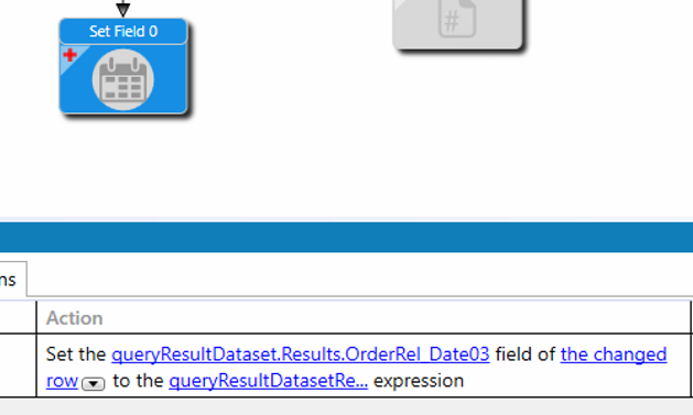

In there you can do this in code or in a set field widget

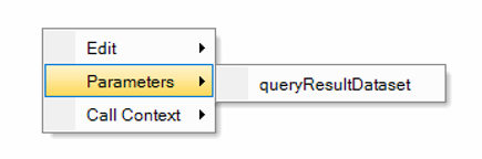

Code. In code you need to do a right click parameters to see what Epicor is sending in as it varies from place to place. In a preprocessing ubaq it is
so I change the code to match.
foreach (var ttr in queryResultDataset.Results)
  ttr.OrderHed.PreviousDate_c = ttr.OrderHed.RequestDate;
