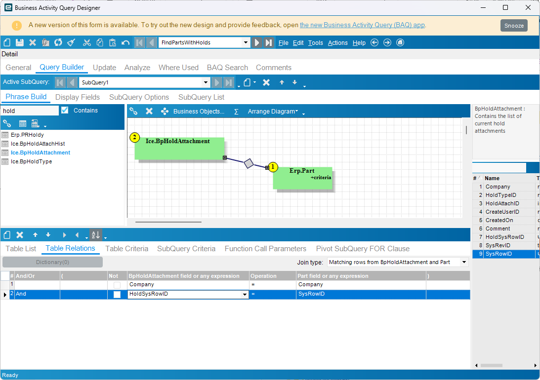

Now, for the life of me I cannot find where I can write a query to show what Parts have holds. Not Part.OnHold filed, the actually Hold Type ID I assigned and attached to the part.
I see some ice.BpHoldAttachHist etc. tables but cannot query these via a BAQ.
Any thoughts?
TIA
Hey George,
Do you see Ice.BpHoldAttachment? That seems to show the current holds for me. (Nothing to do with documents apparently.)
Yes, also going into HoldType Maintenance you can see the Hold History, but testing out pulling the PartNum from the SysRowID match currently. Working on it… lol

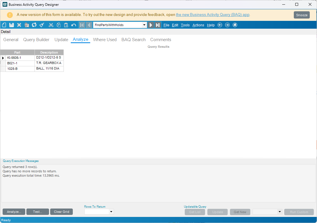

Got it…Thanks!
Ice.BpHoldAttachment.HoldSysRowID = Part.SysRowID
Output PartNum and Desc.

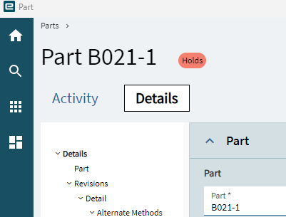

Using BPM Hold on Parts. Verified part HAS the hold attached.

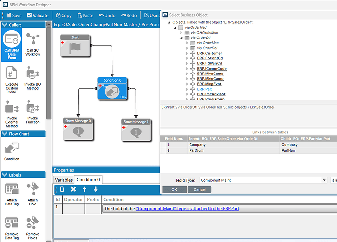

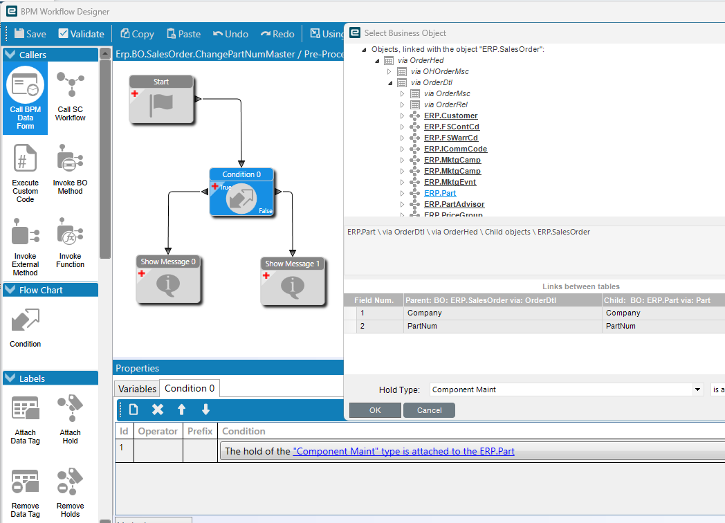

Tracing what BO Method fires when new Order Line is entered is: Erp.BO.SalesOrder.ChangePartNumMaster
Attached BPM to the Method, with “The Hold of the Specified Type is attached to the Business Object” and setting it to my Hold Type and attached to ERP.Part.

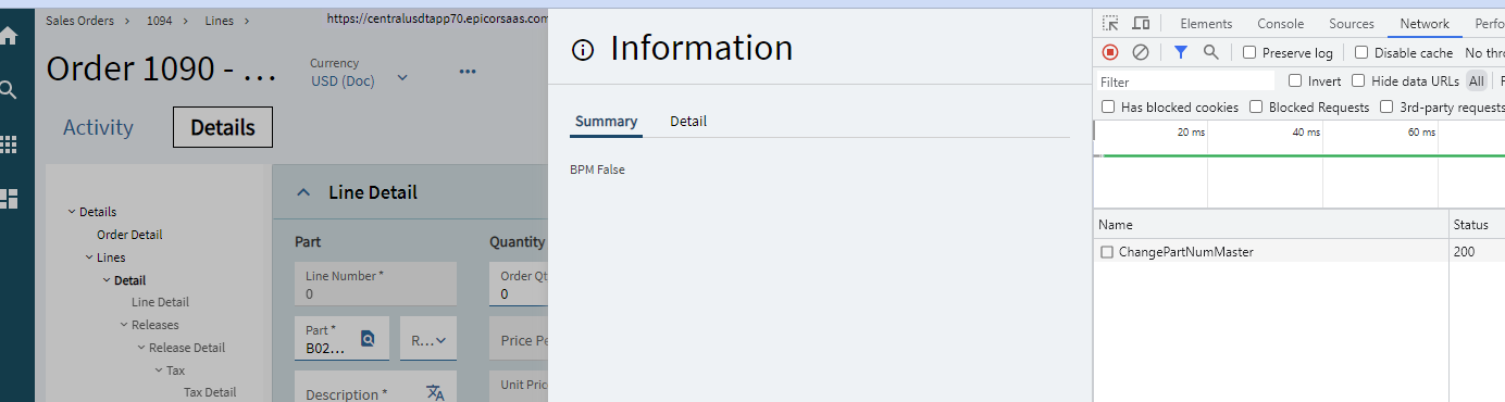

Still, the BPM Fires but always False. It does not see the Hold for some reason. I am missing some step here, but can’t figure it out.
Any ideas on why it does not trigger on the BPM Hold?
Tried Pre-Processing which is where you would stop an action, Post Processing, UPDATE Method, and even looked at DataDirective on OrderDtl.PartNum field, but does not have the option for Hold Type testing.

Yes, I did that first. I have (3) Test Part Numbers and verified the hold via BAQ and the Part shows the HOLDS Tag.

So, I tried the BPM Hold example in the Help and that worked. That one used a hold on a Customer. Not sure why one would work and not the other :man_shrugging:t2:
Theoretically you can rewrite it as query that creates join to holds table [Ice].[BpHoldAttachment] and on SysRowId and checks if something is returned
how it looks like in help?
Yes, the “Working With BPM Holds” in Help.

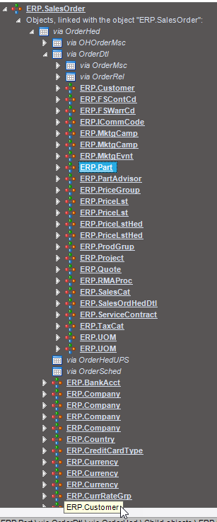

The only difference that I see is that to use the Part BO, you have to go one more level deep in the select BO. See screen shot below. The Customer one is under via OrderHed (it’s the very last one at the bottom). Where Part you have to go via OrderHed → via OrderDtl to use Part.
Yes, that is what I saw also. Interestingly when you select PART, Every other tree in there also has the PART Selected, but kind of makes sense.
Seems like it should work fine, but always fails validation.
Thanks for verifying I wasn’t missing something there, lol
