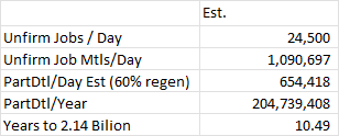

We have about 24,500 jobs created every night by a full regen run, and about 1.1 Million job materials for those jobs. So you can see from the chart here, this seems to be reasonable that we’d run out in about 10 years (the only number I “tweaked” was the one in the middle, estimating about 60% PartDtl records are regenerated nightly.. .that might be really low though)

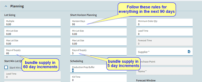

For those talking about HUGE number of jobs created (over 10k per day), I am wondering how many of you are using this feature in MRP.
  1. you can set a SHORT HORIZON planning days… everything within this number of days is planned using the short horizon rules
  2. anything OUTSIDE the short horizon can follow different rules.
In the example below, I am saying that for the short horizon of 90 days (3 months) we actually want to have our jobs bundled into 5 days of supply groupings… (but this could be changed to 1 for one job per day)
in the regular days of supply, i have set Days of supply to 60… what that means is that even if i have one demand per day for a year, i would only get one unfirm job per two month period. This can substantially reduce the clutter of future jobs that will not be released for a long time. This also results in MRP taking less time to generate those jobs.
