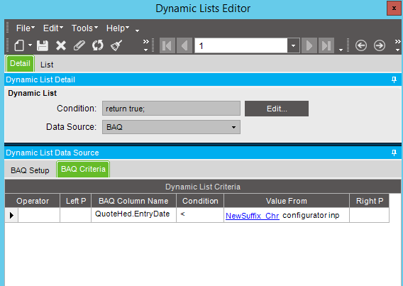

There is a “BAQ Criteria” tab on the Dynamic List… I am fairly sure that this criteria is used as part of the BAQ Criteria BEFORE it is sent to the database to be retrieved.

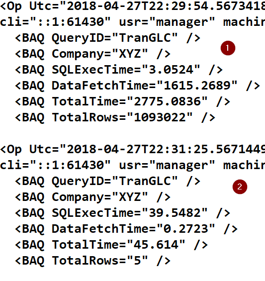

I have traced this before and it does actually pull the full dataset without filtering. Below is an example using TranGLC - for maximum presentation. The part that has #1 shows the BAQ being executed with a filter from the Dynamic List. #2 shows the same BAQ being executed with the filter from the BAQ designer. In theory, if filtered, both would be about the same.
ok… I stand corrected.
