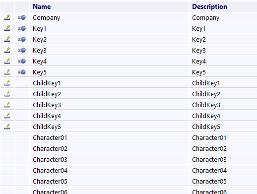

If you are doing the Paste Insert on UD100A then there are Key1 - Key5 which are UD100’s Keys, you must specify those unique as well!, and also ChildKey1 - ChildKey5, which are UD100A’s Keys.
Example:
Key1, Key2, Key5, ChildKey1, ChildKey2, Character01
1, 1, 1, "ImAChildKey1", 1, "Hello"
1, 1, 1, "ImAChildKey1", 2, "Hello" /* this is okay because the combination of Key1 - Key5 + ChildKey1 - ChildKey5 is unique */
If you do the following:
"ImAChildKey1", 2, "Hello" /* Even tho you are not using Key1 it is setting them to blanks */
"ImAChildKey1", 5, "Hello"
Then technically you are setting Key1 - Key5 to “” and it will error eventually.
Snippet of UD100A Schema:

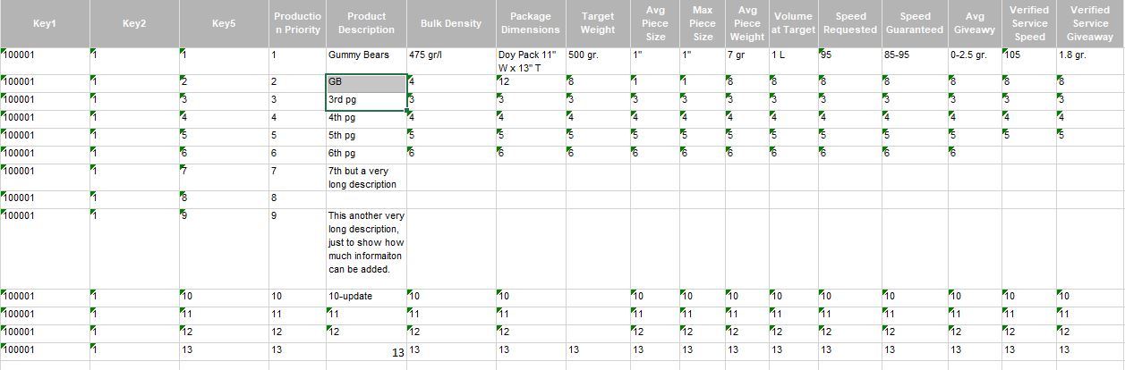

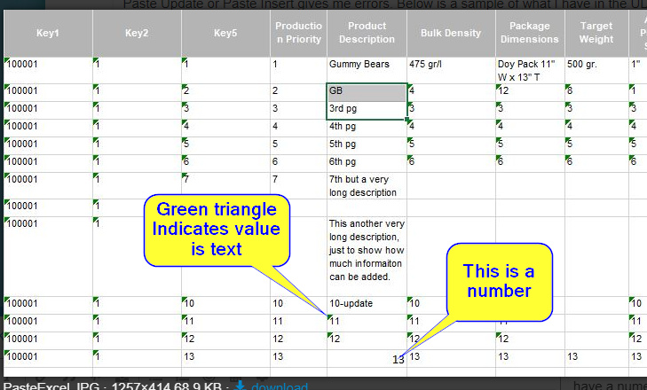

Key 1 is Quote Number, Key 2 in Quote Line Number, Key 5 is always increased by 1 for each new line (making the combination of keys unique). I can manually add new lines and type in the details, but Paste Update or Paste Insert gives me errors. Below is a sample of what I have in the UD table.
What you have there should work since the combination Key1 + Key2 + Key5 makes the row unique.
Try perhaps without selecting the Header row if you havent yet. Also how does your UI Grid look like, I assume its in the exact same order.
I am not copying the header line when I paste update. This excel is made from the UD table, right click, copy to excel, so the columns are in the same order.
Am I better off using UD01 (using only number and short char fields) or UD100 (using number, short char, and some long char fields, only because I need more than 10 char fields).
Maybe its the fact that column “Product Description” (along with a few others) is of type text, and you have a numeric value (as opposed as a number stored as a text).

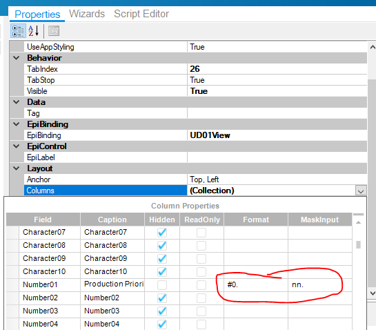

So I now have paste insert and paste update working on my UD Child table. It turns out that the format and mask ID are important for paste function to work. I had an integer column and I did not want to see .000000 after each integer. To get rid of the zeros after the decimal, I input the wrong text on the format of that Column Properties (I did not use the # that is now in my attached image). My incorrect format made the number in the column appear as I wanted (a whole number with no decimal point or zeros after the decimal), but it broke the functionality of Paste Insert and Paste Update. I have corrected the format as shown in the attached image and now Paste Insert and Paste Update work with my UD Child table.
