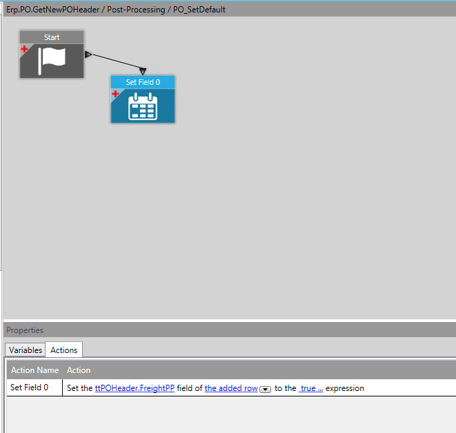

Does anyone know if the Prepaid Freight Checkbox (POHeader.FreightPP) in PO Entry on the Header tab can be defaulted somewhere in Epicor? I am being asked to make to default to yes at all times, but I want to make sure I’m not missing a flag before I create a BPM.
I didn’t look really hard but I couldn’t find a way when we wanted to do the same thing. BPM was very easy so that is the route we took. Screenshot of it below.
