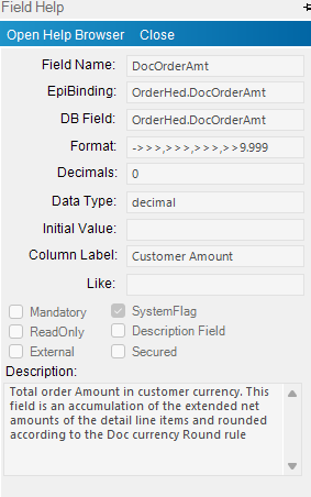

It will also be off by Miscellaneous charges, taxes, etc., whatever isn’t on the OrderDtl line itself.
I alwasy forget, is it OrderHed.DocTotalCharges or OrderHed.DocOrderAmt that includes everything?
