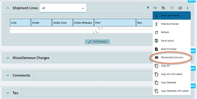

Just to make sure, you are: launching app studio, loading your custom layer, going to the panel card with the grid, and then clicking the elipses and choosing to personalize the columns yeah?
Or are you going into the grid properties and deleting columns/adding them?

I opened the app, opened app studio, created or selected the layer I wanted, chose details, dragged and dropped the columns directly, saved and published.
I had to go to menu maintenance and apply the customization because I previously did not have one.
It did not work until I logged back out and back in though.
I did the personalization before though, and it did work. I haven’t tried it on this screen we are testing now though.

Yeah here’s the thing though, not only do I want to re-order them, I would also like to add and remove certain columns.
I keep thinking I need to do it on the personalization tab, but I read something from @hmwillett that said we should do add or remove columns in the grid properties (add/remove). That post may have been related to a custom grid though, not a base grid.
I am confused regardless.
So how would you add a column if you were going to do that? Grid model or personalization?
If the column you want to show is already in the dataset, you should be fine to do it using a personalization on the grid within app studio.
If it’s an added column, you would likely need to add it using the grid model.
It appears the rules have changed, so I’m not sure of the preferred method anymore.
Depends on the use case. Personalization looks like it can unhide for you.
In customization, it would be the grid model, columns. (& ColumnsHidden?)
That’s why I am so confused. All the columns are already in the dataset. I can see them in the personalization view and have the option to hide or unhide them. I try to do that while in app studio and I see my grid update accordingly, but it never sticks after publishing or when I preview.
Let me try again from base using the personalization method…
See–this is where they’re going to confuse people because now you can ā€œpersonalizeā€ columns within a grid IN an App Studio layer, essentially making it a customization, not a personalization. :roll_eyes:
Yeah, all I know is I want to hide/unhide columns that are present in the dataview AND I would like to re-order the grid.
