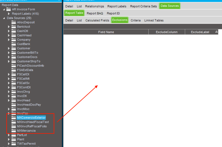

Is anyone else having problem adding new tables into the ARForm data definition? We have just switched to 10.2.200.3 (from 10.0.700) and as soon as I add a table (OrderHed link to InvcHed with Company and OrderNum), when I try and print, using the new RDD, I receive error telling me query exceeded 1024 columns. This happens even if I exclude all columns from the newly added table.
Here is the error:
Program Ice.Services.Lib.RunTask raised an unexpected exception with the following message: RunTask: CREATE VIEW failed because column ‘SignatureText02’ in view ‘RptLabels_C5E65FDD401E4369B120C9CDF6B86292’ exceeds the maximum of 1024 columns.
You’ll need to exclude unneeded columns from the RDD. Giant pain in the rear, but the ARForm is notorious for this.

I experienced that giant pain in my rear the whole day and night yesterday!! I kept excluding columns I thought are not used and I still got the error. At some point the error changed to missing Calc_… fields where I never excluded a calculated field.
I think I should have clicked on Sync datasets after the exclusions. Something I didn’t do and will have to do today and see if it makes any difference.

Might not be your case…
But you cannot exclude a column that is referenced in a table relationship.
So if the original RDD has InvoiceNum as a field, and you add the InvcHead table, linking the InvoiceNum fields, you must still include InvcHead.InvoiceNum, even though it will be a dup of OriginalRddTable.InvoiceNum
