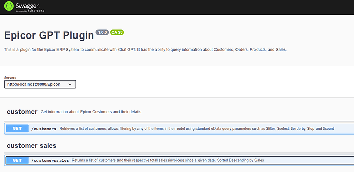

I was playing with this idea a bit last week, threw together this example.
I don’t know how companies would feel about an Open LLM having access to all their private family jewels but the concept is definitely intriguing. The incredible thing about this is that since Chat GPT already “knows” the Open API Specification all I had to do was point it to / tell it where to find my Epicor API, I only gave it access to 2 BAQs zCustomer01 and CustomerTotalSales (SUM(InvoiceHead.InvoiceAmt) generated a SWAGGER Specification for them
and off to the races! Since it consumes Open API though you could just point it straight at your Epicor API… but that seems like a lot of Trust!

How it knew where to take the sum? from description or fields label?
The BAQ was already a summary by customer in this case. But yes it will take the descriptions of the fields and make “assumptions”
So if you name it randomly, it would fail?
Yes absolutely it looks at the OpenAI Descriptions to figure it out.
It can also write so it can make or order for you if you ask it to the problem is how does it figure out what’s required l. I think you have to have an endpoint that returns only required fields or something so that I knows what to ask you for :thinking:
