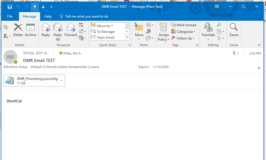

I think i have missed a step or something. I have set up my SMTP server in my config file. I can email from Epicor but when I select (FOR EXAMPLE a DMR) file > Send > Record by Email it emails fine but when I get it there isn’t a link just a sysconfig file. and in the body it says shortcut. It is acting like it couldn’t attach the record.
You have to register sysconfig files to open with Epicor.exe in your windows file association,.
