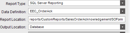

Is the report type: SQL Server Reporting and is the Output Location: Database?

Yes

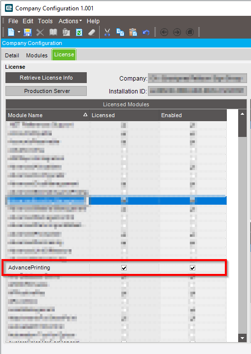

Is APR activated? Go to Company and check your license to see if it is active.
Both Licensed and Enabled are true?
No they are both not checked. Which leads me to believe that my CAM was incorrect.

Turns out that we started paying for it before I started here and no one ever enabled it in the Admin Console. So seems to be working.
