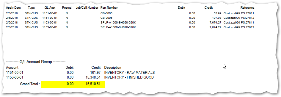

  5. ran the WIP/Recon report.
I see the 4 STK-CUS transactions but only the credits, NO DEBITS to the COS accts!!!
The WIP /Recon even shows unbalanced GL Transactions!!

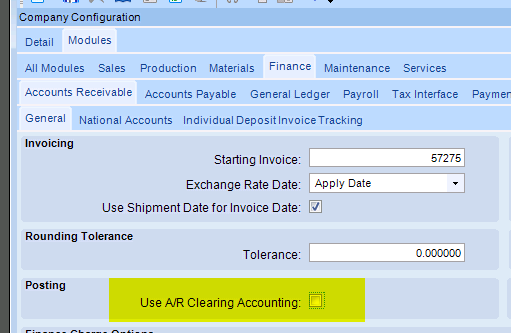

There’s a setting in Company Config (pict below). Unchecking the “Use A/R Clearing Acct”, causes shipments to debit the COS directly, skipping over the need for an Invoice to do it.

Transaction Type Invoice on Inventory WIP Reports only works in conjunction with IF AR Clearing Account is Flagged True in the company config.
if Its False system directly debits COS which does not require any further process to recognise the COS.
This is By design.
Regards, Habib
