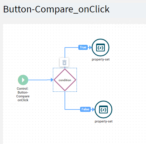

Here is an image of the button/event logic/flow

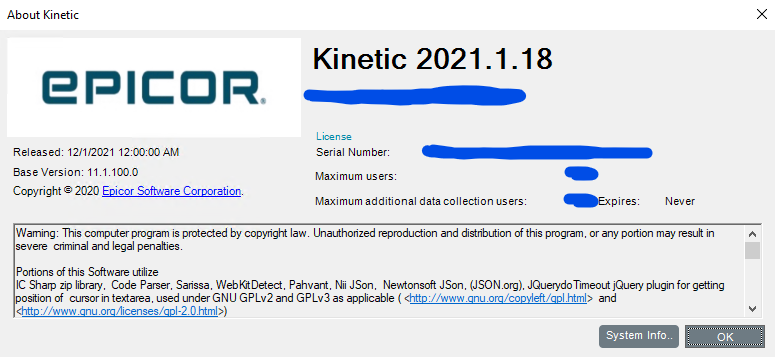

Here is what I see about the version
Unless I’m reading that wrong is looks like its telling me that the version is Kinetic 2021.1.18. I think i mistyped when I put 2020.1 my eyes are going crossed at this point..

Your condition would be formatted like this:
'{TransView.Text1}' == '{TransView.Text2}'
Just use whatever dataview.column(s) your two two textboxes are bound to.

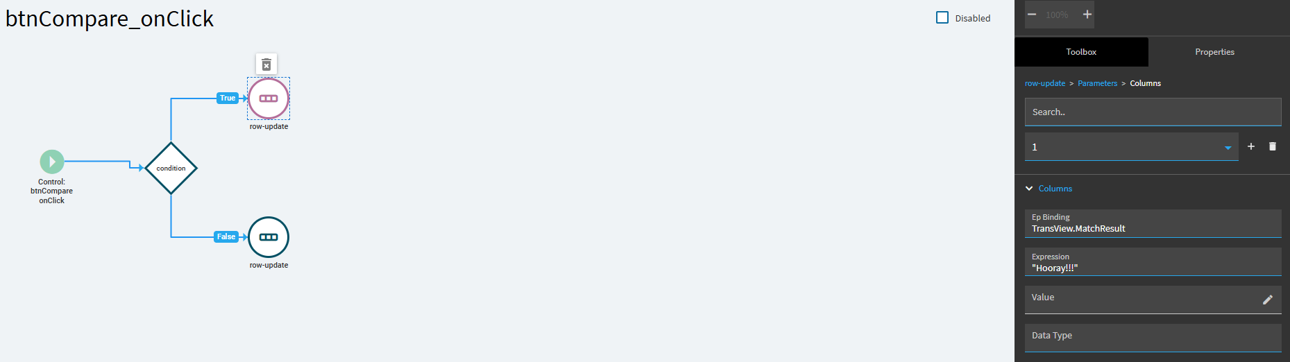

Also… instead of a property-set… just set your MatchResult text box to another generic binding. I used TransView.MatchResult. Then you can just do a simple row-update on that binding to present whatever feedback you want.
Results:

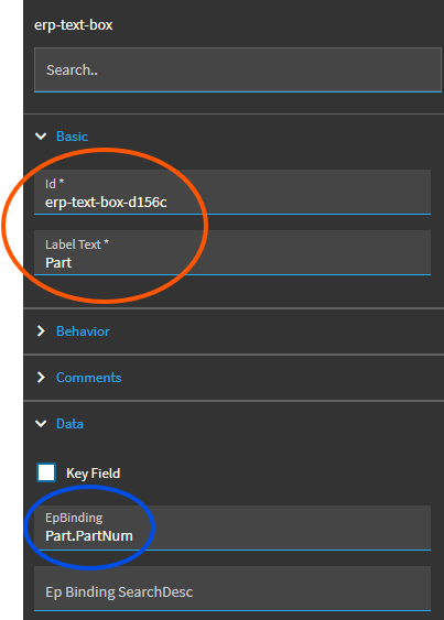

Let’s take the below textbox as an example:
The ID and label text really aren’t that important in this context. What matters is the EpBinding. This is where the VALUE of this textbox is going to be stored. In this case, whatever I type into this textbox is going to be stored in the ā€œPartā€ dataview, in the ā€œPartNumā€ column.
And you can create temporary dataviews on the fly. So, if you set up your textbox bound to tempview.Barcode1 (for example)… it is going to create a temporary dataview called ā€œtempviewā€, and store whatever you type (or scan) into that textbox in a column called Barcode1.
You would do the same thing for the second barcode.
Then your button click event is going to compare the values stored in those two bindings. They are temporary. You’re not writing anything to the database… in this case they are just a runtime dataview.column references you use during the current session.
