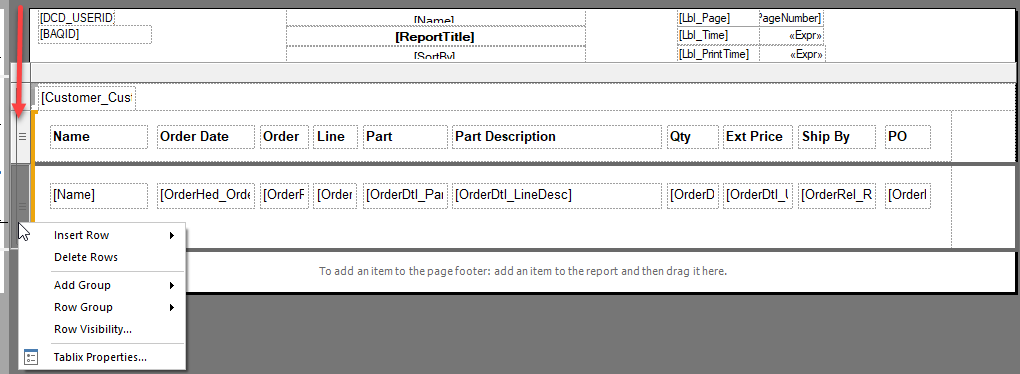

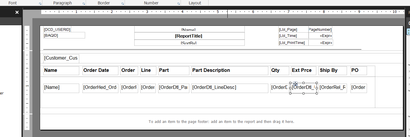

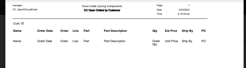

I’m facing an issue while working on an SSRS report that is intended to display Customer specific Open Orders. The data stopped showing up while I was in the process of adding columns and testing the output using the BAQ report designer.
Initially, I suspected that one of the newly added columns might be causing the issue. I removed the recently added columns. Unfortunately, this did not resolve the issue. To make matters worse, I made the mistake of saving and closing the report after making changes, preventing me from using ctrl-z to undo the changes.
I would greatly appreciate any guidance or suggestions!

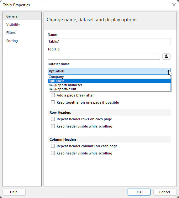

Your Tablix’s dataset is pointing to the wrong one. It is currently pointing at RptLabels and it should be BAQReportResult. If you right click in the side and select Tablix Properties, you will be able to change it.
I figured out how I messed this up. I added a column from the label dataset inadvertently which changes the Tablix dataset. When I save, exited and went back in to remove the columns it didn’t revert back to the BAQReportResult dataset
