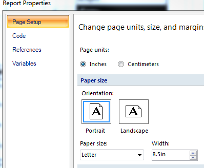

Hack 1: my PM suggested to increase the width(i set 8.5) of the report page. so that report will always insert a blank page after report body . Now, the blank page will have report header & footer. this mean, odd page will have packslip content and even page will be blank but contains report header & footer. using page number, replace the report header with terms and condition or shipto information on the blank page.
Hack 2: dynamically increase/decrease the report header & footer size based on page number to accommodate report header (company information) and auxiliary document. I have not figured out a way for it.
Using Hack 1, we are just displaying ship to information on back of all even page, and odd page have the pack slip info.
