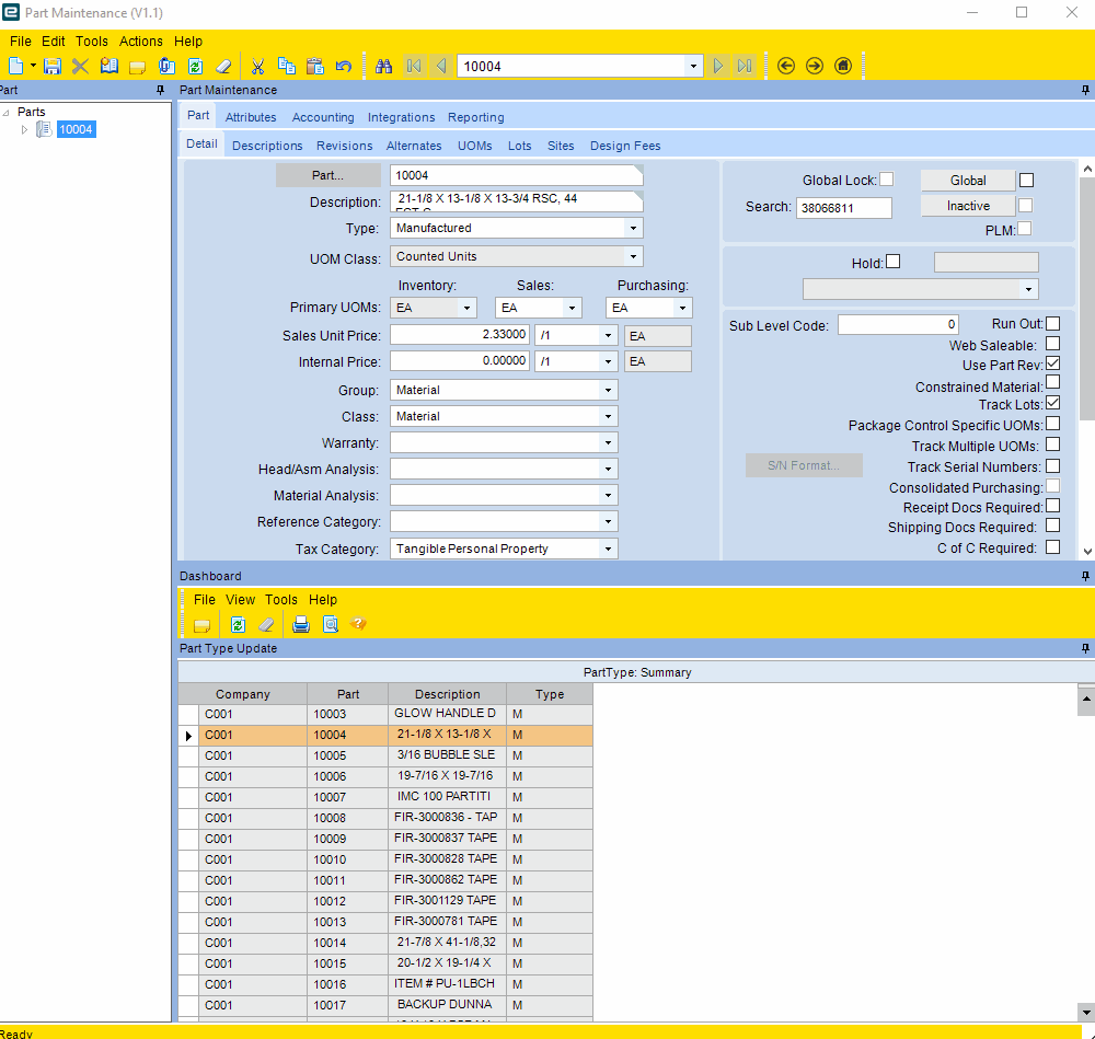

Turns out this is pretty easy. I used Part Entry, but modify to your needs.
  1. Create the BAQ and Dashboard

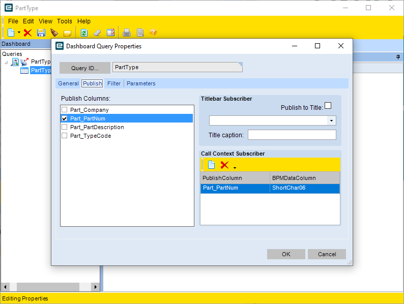

  2. In the dashboard, right click the query and go to properties
  3. Add the keys as publish

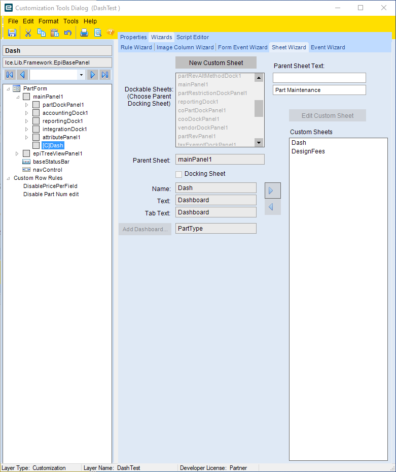

  1. Customize the UI and use the Sheet Wizard to add your dashboard

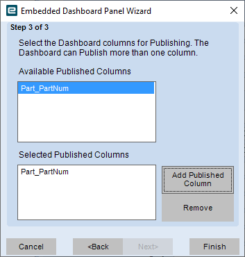

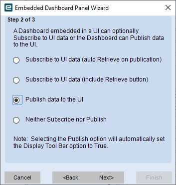

  1. Mark Publish data to the UI
  1. Add your published columns.
  1. ???
  2. Profit
PublishToUI

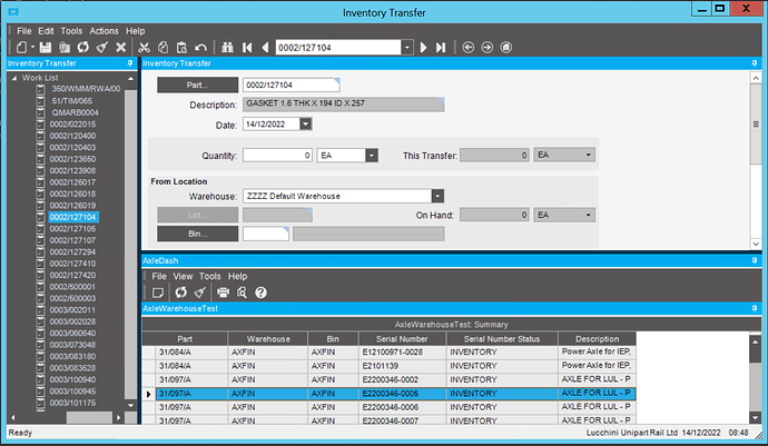

I think I may have bigger problems then. This is exactly the method that I have run over my inventory transfer sheet.
When I run my example, the part number does not change over. I’ve whittled out the wahoure and bin also just to see if it picks up on the PartNumber but alas its just not grasping it.
I’ll keep playing with it and see what the problem is but no wheelbarrow for me as yet.
Can you show me how you set it all up?
