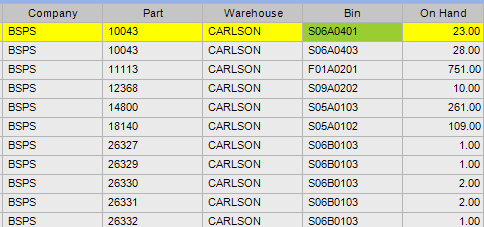

Yeah so far UBAQ doesnt force the method. I can change the bin on the grid, for all parts in that bin. But it does not save, so i’ll have to trigger a method I think, which will do all the other things like write to parttrans table.

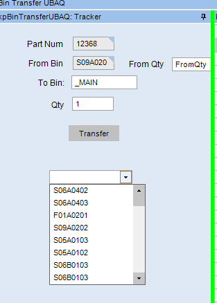

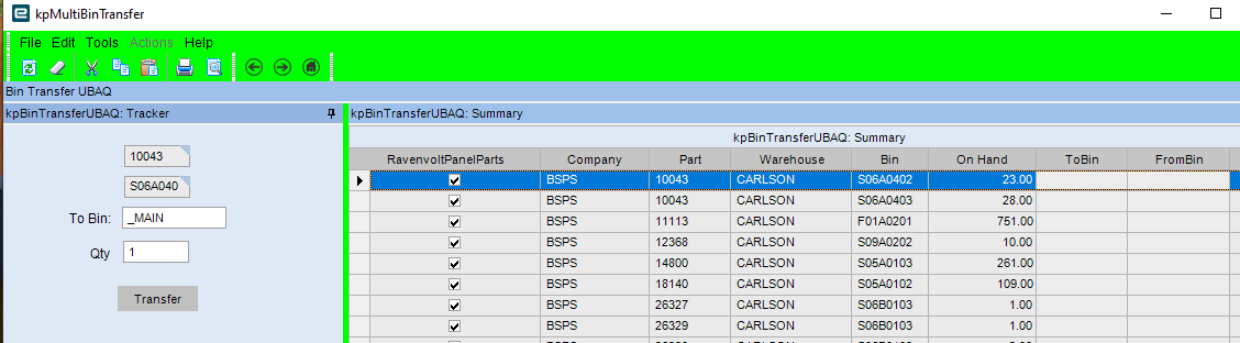

Here is the layout to show what im going for. So far can click through list which will auto fill FROM bin and PARTNUM. No code yet :stuck_out_tongue:

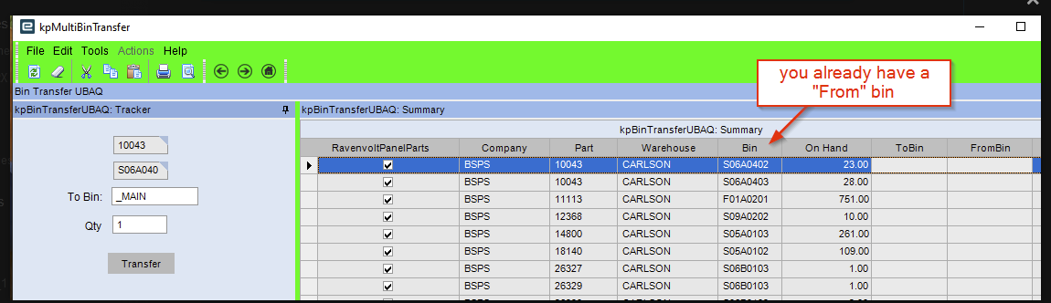

You already have the from bin. That’s where the inventory already is, so you don’t need to add a new one.
You’ll want to make the to BIN a drop down. Use a BAQ combo and you can drive it with a BAQ so that they can’t mess it up.
Watch this video from this time, and it will show you how to make an updateable field into a dropdown. (that way each row is a dropdown for the bin.) then you can use the same BAQ to wire up to the BAQ combo in your tracker To_Bin field (which should be unbound BTW)
Good idea with the combo bin, I can put the valid results into there with a seperate BAQ. One way street =)
