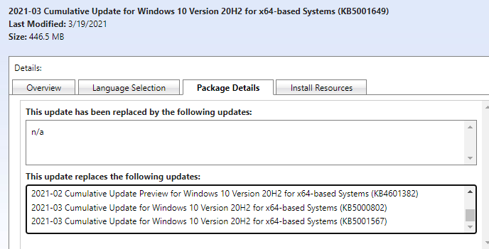

There is a new Microsoft update available March 19th, KB5001649 that replaces KB5000802 and KB5001567. In the update history it gets listed as an ‘Other’ update rather than a ‘Quality’ update as KB5000802 is listed. The PC I have installed this on is not showing the issue, but it’s the only one I can test on today…

So we’re thinking that KB5001649 is like a “fixed” cumulative update for March (and thus, being cumulative, suppose it would replace the February one too) that actually works to not break Epicor performance? Is that how you’re reading it @kena ?

Adam Yes, thats what I am thinking. Either it’s ok with this update, or something about the specific configuration of the PC I was testing on is having it not break Epicor.
Jonothan - Yes, the PC I was testing on had KB5000802 installed prior to KB5001649. It also had KB5001567 installed prior. I wasn’t seeing the issue with 1567 either, so try to that level if they have pulled 1649.
