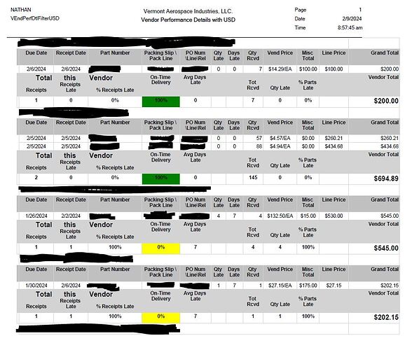

I just created something like this. You will have to update the BAQ on the Vendor.VendorID table criteria. I used paste/insert to pate in a whole list of applicable vendor IDs. The BAQ shows vendor (supplier) performance over a date range. The BAQ has lots of extra fields because it is used in a BAQ Report.
BAQ:
VEndPerfDtlFilterUSD.baq (49.9 KB)
BAQ Report:
VendPerfDtlUSD.xml (2.4 KB)
Note that the Parameters in the BAQ are useless right now. I just forgot to remove them. If you run the BAQ through the BAQ report, then the parameters in the BAQ report should override the BAQ.

Unfortunately, my companies IT policy blocks my viewing this. Can you post a pdf to view? Here is how I want to score them.
Supplier Performance Report.pdf (648.9 KB)
