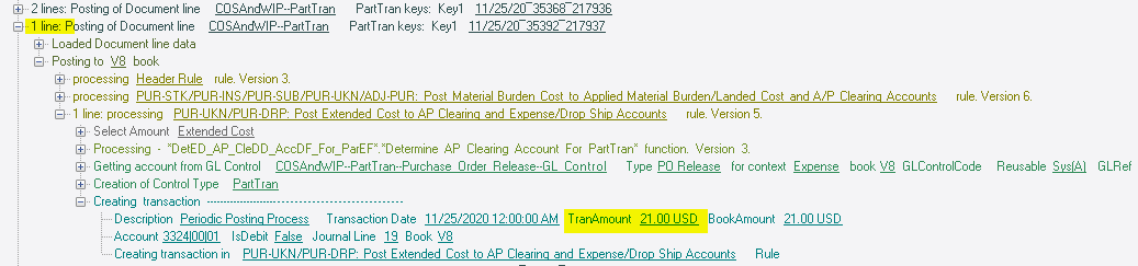

Well … it appears to be a backed dated entry, as the PE Log shows:
But the odd thing is, why would half the Transaction appear to process okay?
I’m blown away that it says it’s from October but the IWR says November. Or is it a different transaction?
The plot thickens …

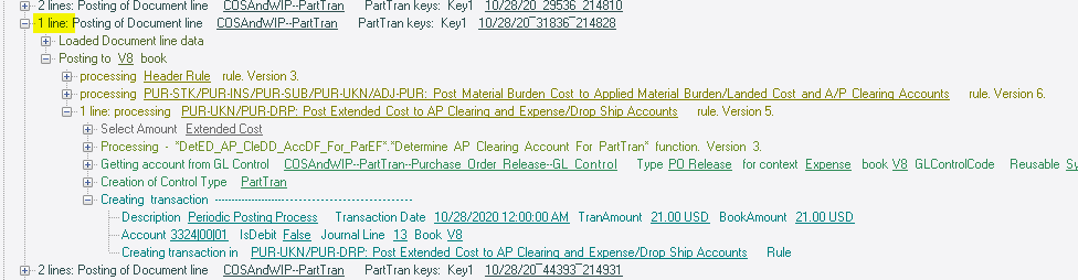

Turns out that part .25" GREEN ROPE was purchased twice. Once on PO 50414 and again on 50514 (yes, exactly 100 PO #'s apart!)
There was a receipt against PO 50414 on 10/28. Running IWR for 10/28 (and just PUR-UKN), and that part only shows once. And the PE Log for that running of IWR is what IO posted above. Further examination of that PE Log shows an unbalanced line:

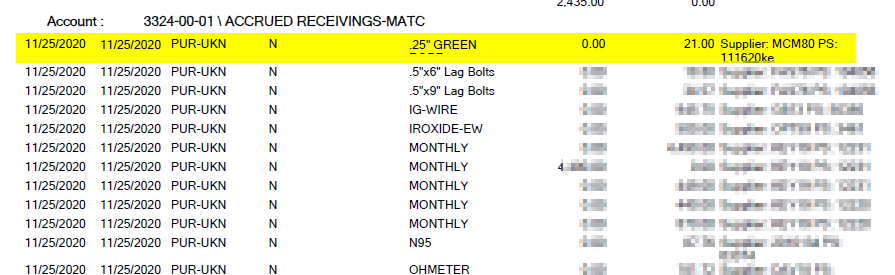

There is another receipt, but against PO 50514 on dated received today (11/25), but with a pack slip number that looks like an user created P/S number of 111620ke (KE is one of our purchasing folks initials). So I’m guessing that “P/S” really stands for “created on 11/16/20 by KE”.
  • This one also only appears once on the IWR for 11/25.

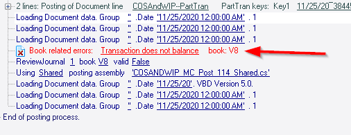

  • The PE Log for this running of IWR shows one non-specific error

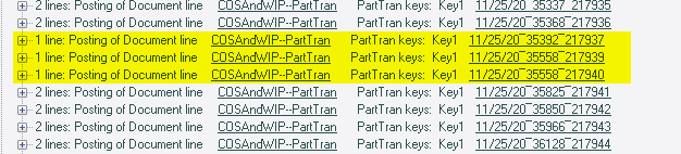

  • Expanding the PE Log lines shows (3) rows with a single line. Normally each row has “2 lines:”
    • image
  • Expanding the first of the three rows, shows that it is the Item in question
So this demonic OTF part number has caused the issue twice…
