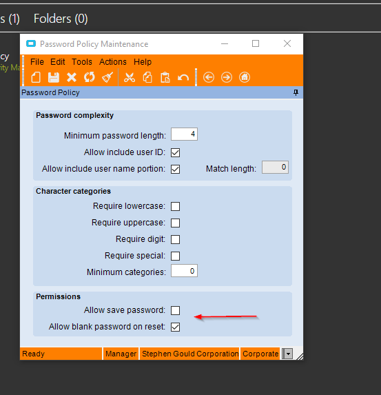

Brandon,
As of E10 you can’t do this any longer manually. You can do it inside epicor. There’s a new Password Policy Maintenance Screeen that needs to be set to Allow save passwords
Once this is set then inside of Epicor you can chose to save the password which will be encrypted and stored in the sys config
