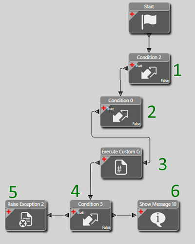

Regarding what is all happening in the BPM, here is that information:
  1. If LaborDtl.RowMod = “U”, then continue on.
    a. If it is “A”, that means it is being called during “Start new production activity”, which is not what we want.
  2. This is an old conditional that was in place which always returns true. I had it for debugging purposes and failed to remove it before this screenshot was taken.
  3. This is the custom code block that was posted earlier
  4. This checks to see if ‘tooMany’ in the code above was set to true. If so, it moves onto #5, if not, it goes to #6.
  5. Raise Exception saying “Hey, you can’t complete more than what was completed in the previous op”
  6. Just a Message box saying “good to go” (just for debugging…it will be removed when I put it into production)
When I supply a value that is more than allowed, the Raise Exception box does get triggered and is displayed, however the InfoMessage.Publish messages from the code block never appear. So I know the BPM is firing all the way through, it just seems to ‘overlook’ some steps.
When I put in a valid value, I get all of the InfoMessage messages, and the “good to go” message.
