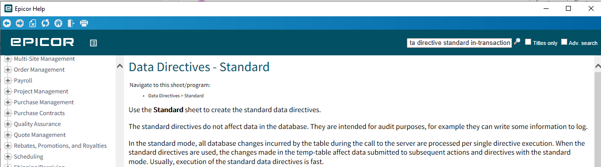

I have a Data Directive to Unallocate, Move Inventory, Reallocate. I have the Unallocate portion in another code block In-Transaction, since I need to Unallocate, before it moves the inventory to another bin. Below is the Move inventory code and is the only Directive I have enabled. Using this exact code, works In-Transaction but errors in Standard. Error: Error Creating Part Tran, Please retry.
Ahh, thank you. As you can tell I’m new to this whole epicor thing
Also if you are using any conditions against RowMod (added\updated\etc) you can have issues (doesnt seem to be applicable in your case here).
This is because after a BO update processes the rows (using RowMod to determine action), in most cases the BO will clear the RowMod making your conditions fail.

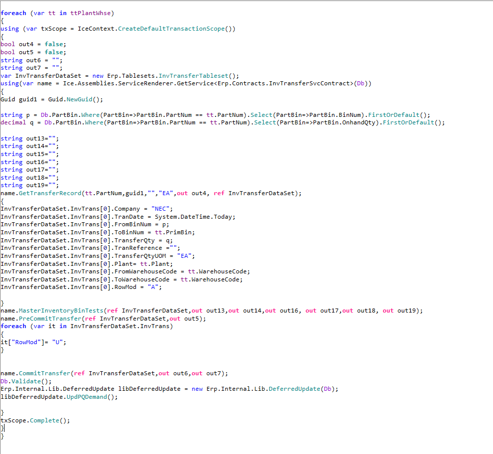

I also faced this issue while performing multiple inventory transfers in a loop — Epicor was showing the error “Error creating PartTran. Please retry.” This happens because Epicor uses a deferred processing queue, and changes made by CommitTransfer() aren’t immediately finalized. To resolve it, I added the following code after each CommitTransfer():
Erp.Internal.Lib.DeferredUpdate libDeferredUpdate = new Erp.Internal.Lib.DeferredUpdate(Db);
libDeferredUpdate.UpdPQDemand();
This manually triggers Epicor to process any pending updates from PartBinDeferred, finalizing the transfer before the next one begins. This resolved the issue and allowed smooth back-to-back transfers.
