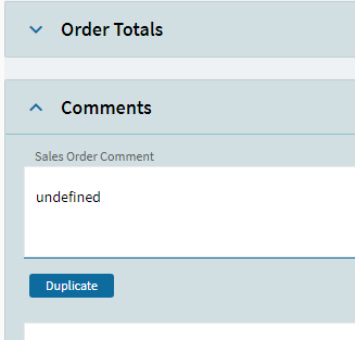

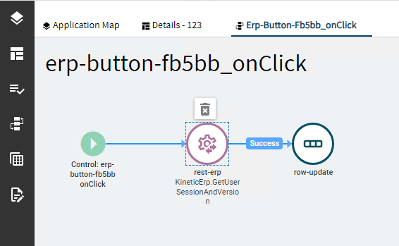

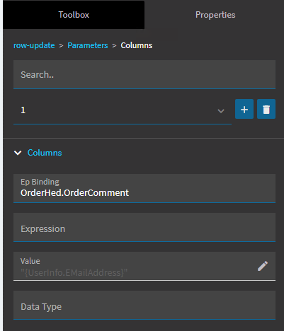

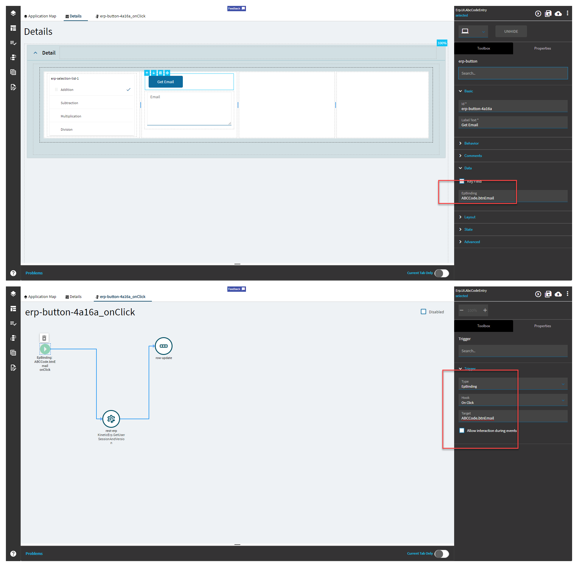

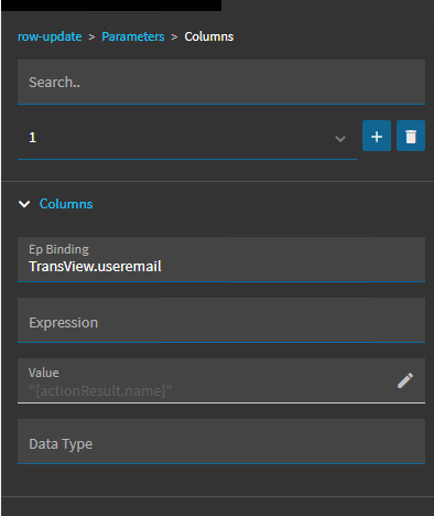

I’m wanting to grab user session data via button click → rest-erp control then fill an OrderHed.XX field.
Then on the row-update control use the following…
The result comes into the EP Binding field as (undefined).
What am I missing. I can see that the res-erp request is successful and returns the REST response in Developer Tools. But the row-update doesn’t successfully parse the data.

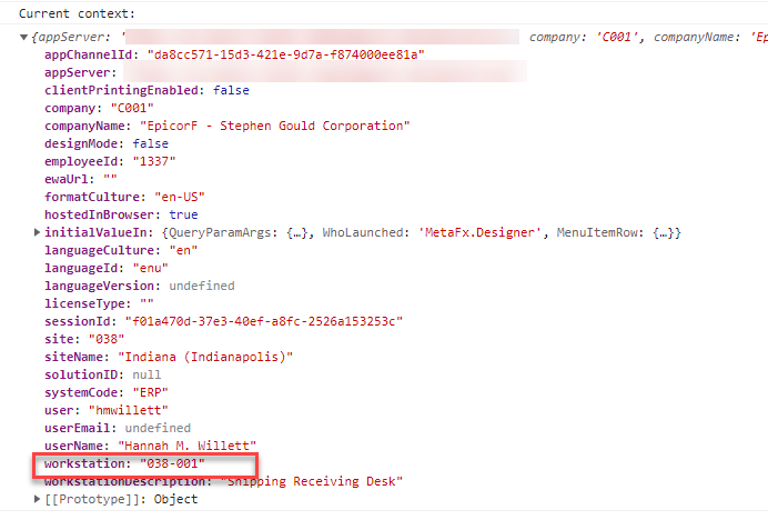

This post shows a nice screenshot of what is available in session context
%session.context… does work but I’d like to get the current user email. I think that field is also in session.context but is empty.

I do see now that %session.context.userEmail% does not work.

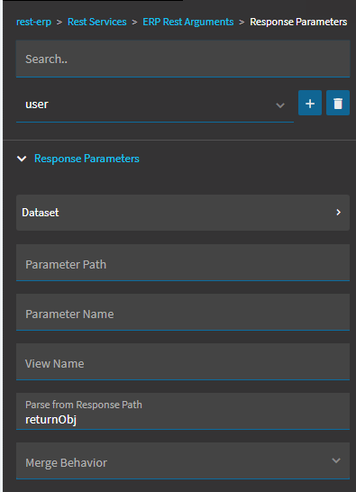

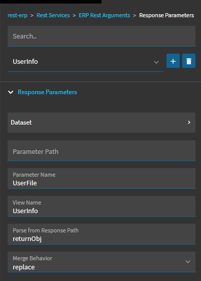

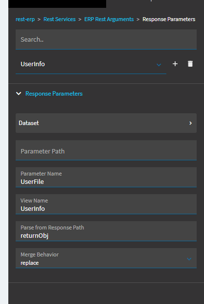

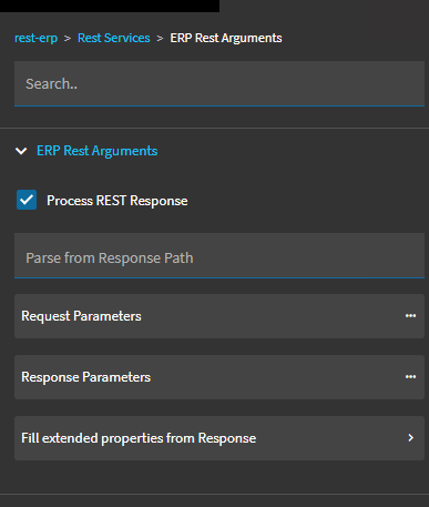

You will want to create a view to hold the returned data from that call, however, I tried every iteration I know of to handle the response parameters and never parses the rest response correctly.

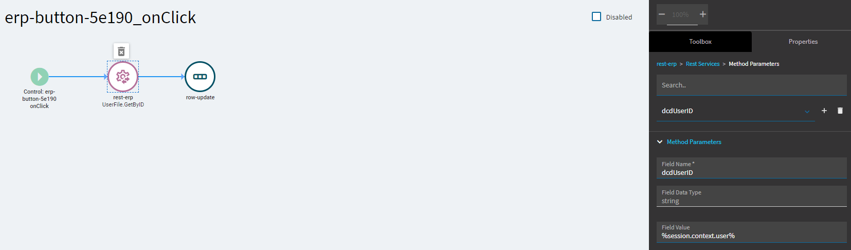

As a workaround you could call UserFile.GetByID and passing in the parameter value %session.context.user% and parsing the result to a custom dataview

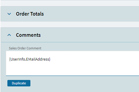

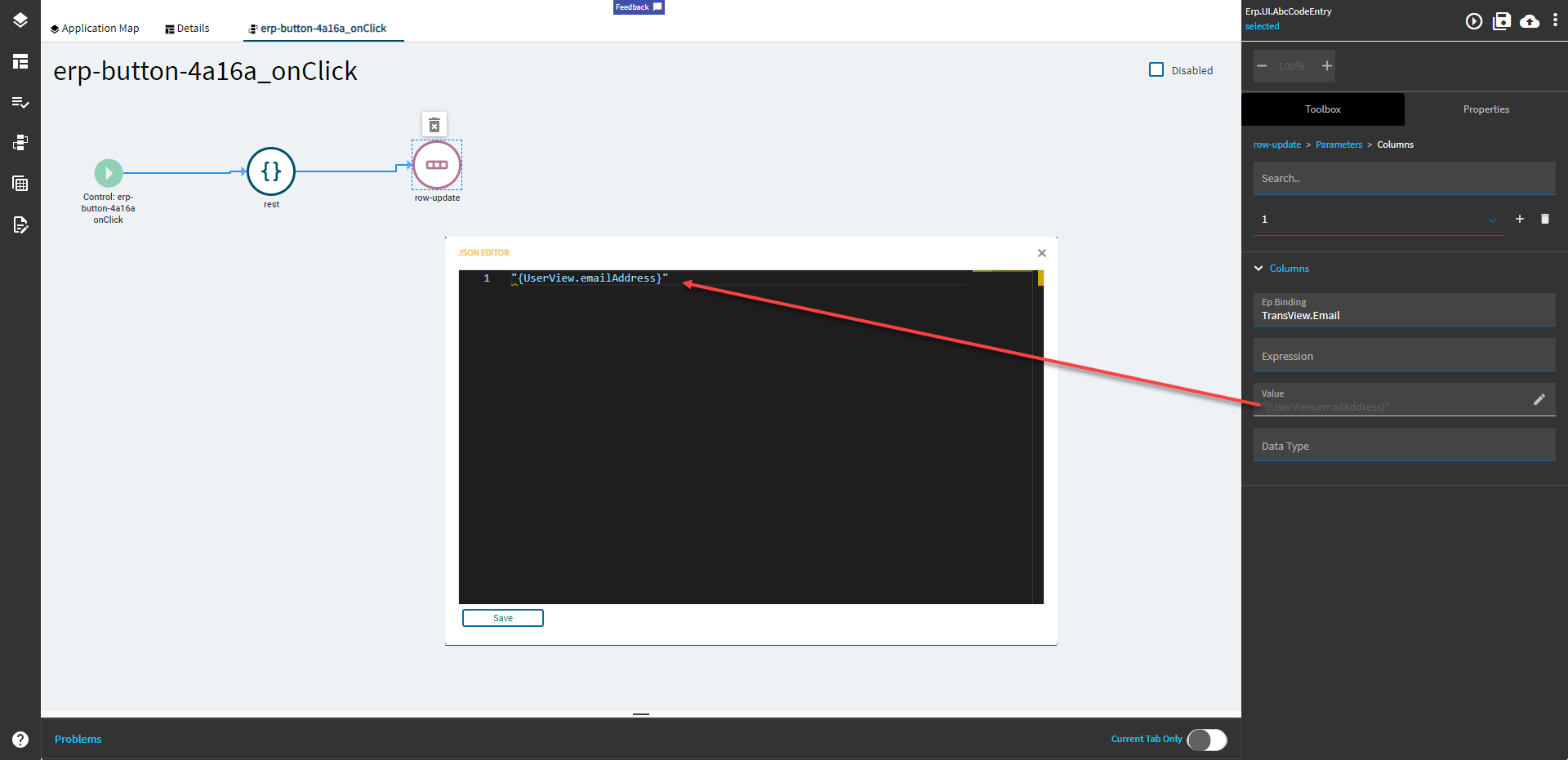

Tried this approach and I can see the response results come back successfully from Developer Tools. However the binding returns {UserInfo.EMailAddress}. Seems like I’m really close though. What am I missing? Did I spell something wrong maybe?

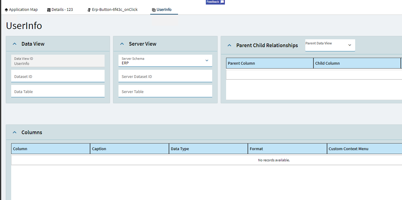

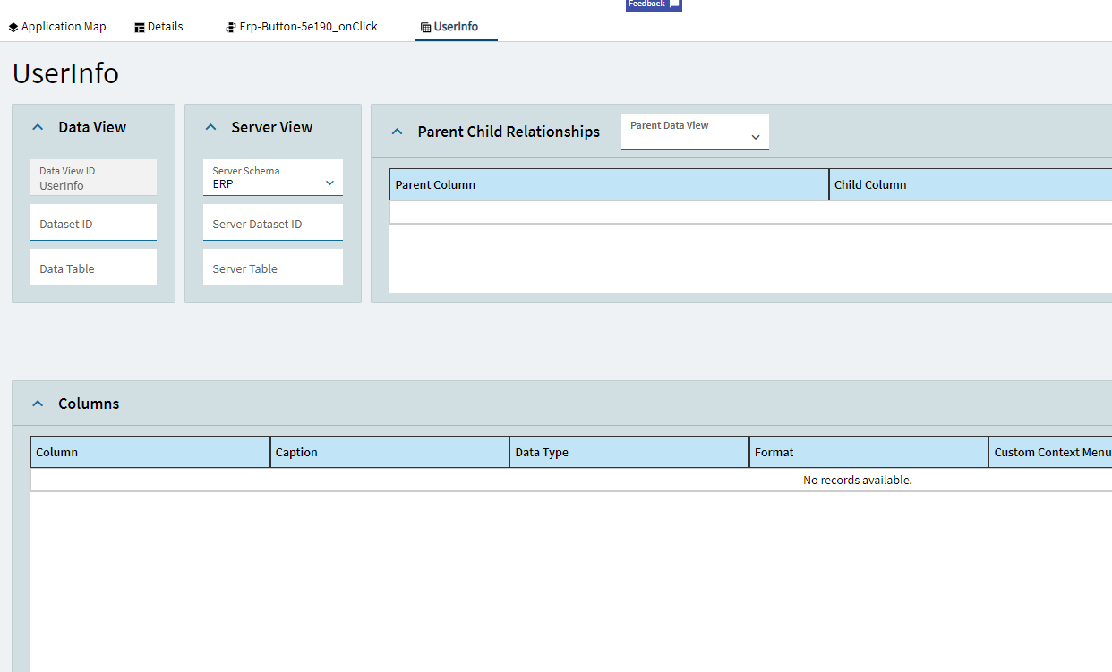

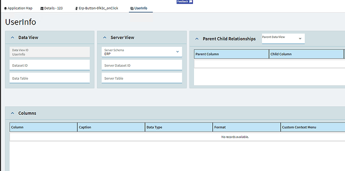

Did you add UserInfo as a dataview?

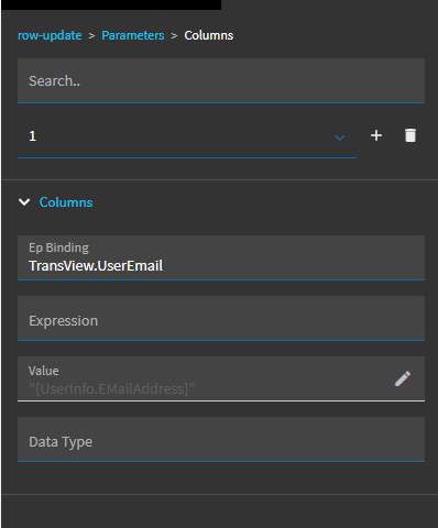

I didn’t have the view. I’ve now included it. However now the binding returns “undefined”. Is there something else I have to set up on the view? Do I need to verify that it’s being filled (and how would you do that)?
Make sure your UserInfo view is being populated, this post outlines debugging in Kinetic
Success… thanks so much for your help!
I noticed in Developer Tools that the GetByID request was no longer happening. So I removed the response parameter and added it in again. From what I can see there are no differences but it now works. I read in another of hmwillet’s posts where she mentions that you can do this without a dataview and just use actionResult, but I couldn’t get that to work. I must be missing or misunderstanding some detail.

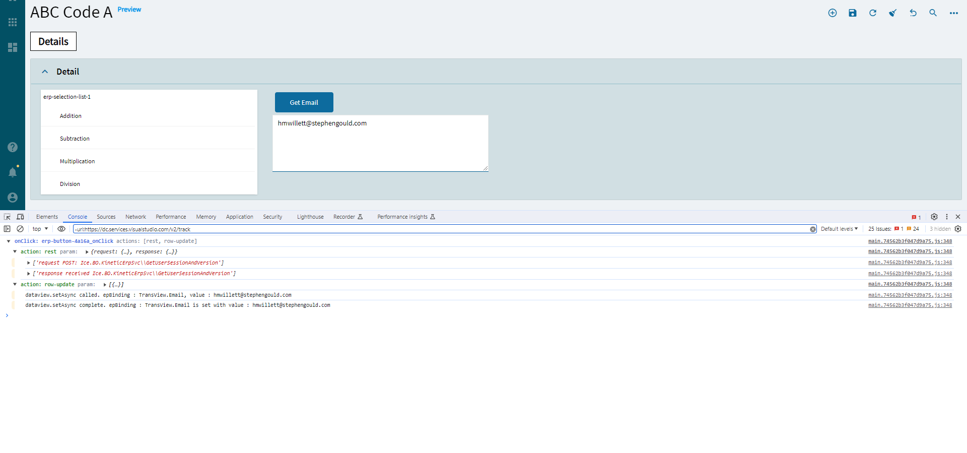

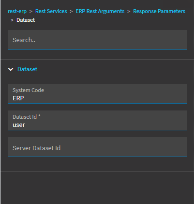

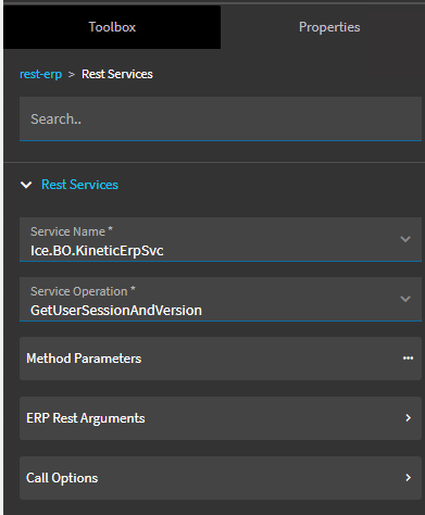

Okay–you piqued my curiosity with the Ice.BO.KineticErpSvc call and after much trial and error, I got it figured out…
The issue with this particular call is it returns an object instead of a collection. The typical rest-erp widget likes to iterate through something and there was nothing to iterate through.
I was able to get it to work using the “Generic” rest widget.
Do with that what you will.
I was just annoyed the call wasn’t working as the others do and was determined to figure it out.

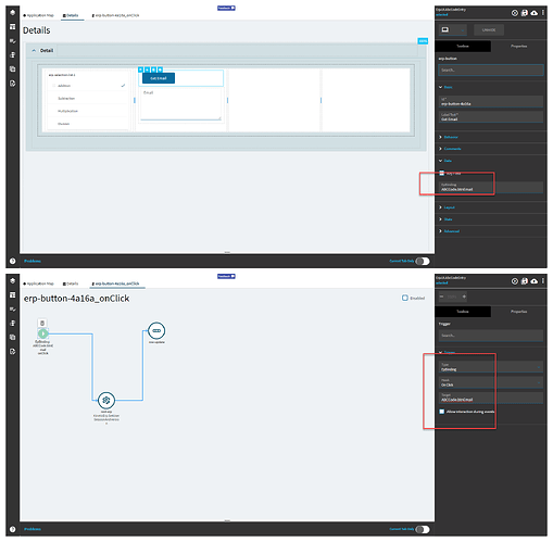

Another thing I noticed is the very loose reference to events. For example I can create the onclick event for a button and design the logic, but if I change the name of the button then all references are lost and it’s very difficult, if not impossible, to find the previous onclick event name, let alone to try to point the button to that event again, which means rewriting all the logic.

A different approach would be to leave the ID of the button as it is, give it an EpBinding, then change the event to EpBinding/OnClick/WhateverYourBindingIs. That would prevent a bit of that issue unless you’re changing the binding and I would suggest just… not doing that, lol. You can also start using Row Rules to affect said button if it has a binding like enabling or visibility or whatever.
You’ll get this no matter where you customize something.
In BPMs/Functions you have to should comment your code, give it appropriate descriptions, group names, etc. It’s no different in App Studio. Name your events something meaningful. Instead of erp-button-4a16a_onClick, rename it to ce_btnEmail_onClick (ce_ is my prefix for custom event). You can also add comments to every widget and every event in App Studio.

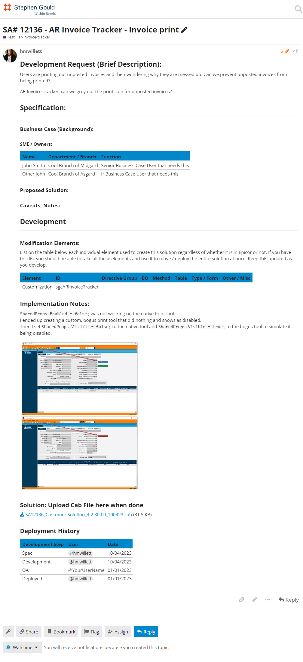

At Stephen Gould, we have our own Discourse site where we log everything about a customization we work on.
Here’s an example of one I did this morning:
