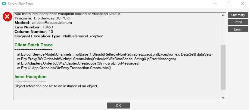

BPM Code Failure - Need extra eyes
Had my code working, creating POs for any jobs cut using Order Job Wizard but realized I need to put in a validation to make sure we’re not creating POs more than once. My code fails with an index out of bounds message, and I have no idea where it’s coming from. Hoping a second set of eyes can spot something obvious or might even offer a better solution, I’m a noob with C#. What I’m looking to do, enumerate through jobs, find related POs, if a PO is found, stop, if no PO exists, create one and add lines.

I would change:
 var PORel = (from por in Db.PORel
          where por.Company == Session.CompanyID
          && por.JobNum == Job
          select new {por.PONum}).ToArray();
to
          select new {por.PONum}).FirstOrDefault();
Otherwise I don’t think PORel will ever be null.

I was afraid I was going to get this answer… Guess I’m going to need to study up a little more and see if I can make this happen with a joined query.
Okay, I’ve managed to eliminate the half dozen loops and use a joined query to get my job data, but now I’m running into another issue when trying to create the PO lines. Any clues here?

When you’re assigning var query = (...).ToArray(); you will get an object back. This object will be at minimum query.Length = 0, it will never be null.
If your query is supposed to return 1 row then I’d use FirstOrDefault() instead. Otherwise use DefaultIfEmpty()
Or change your conditional statement to:
if(query.Length != 0)
from
if(query != null)
I appreciate the explanation @Doug.C, I did change the IF statement to use (query.Length != 0), but I think my issue is that I’m not backing out of the loop, before creating the PO, and using a global variable for query, then doing a loop to create the lines.
I’m having trouble initializing the query variable at the beginning of my code :frowning:
Got it! Rather than trying to use a global variable, I just nulled the POtable from the start and used an IF statement to create the PO if it didn’t exist, making it not null, them adding the lines in my loop. Approving the PO at the end. Seems to be working perfect now.
Thank you @timshuwy and @Doug.C for pointing me in the right directions!

Much better… but depending on where you have this code running, you MIGHT have TWO temporary records in the ttJWOrderRel table… one with RowMod = “” and the other with RowMod = “U”. You probably only want the updated one. Right now you are running it for every row found.
You might check to make sure that you only run this one time.
This is on a post-processing method directive, OrderJobWiz.CreateJobs. I think I’m only getting the rows I need, if I display a message to show the row details after my query I’m only picking up the specific lines I’m working with. So far so good, we’re going to test in production today.
