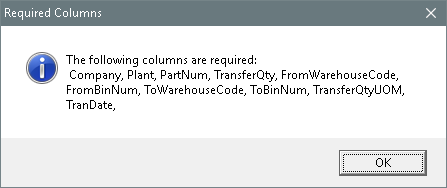

All you need is an excel file with the following columns
There are more fields (like TranReference for adding a comment. I’d include that field to) - but they are all optional.
