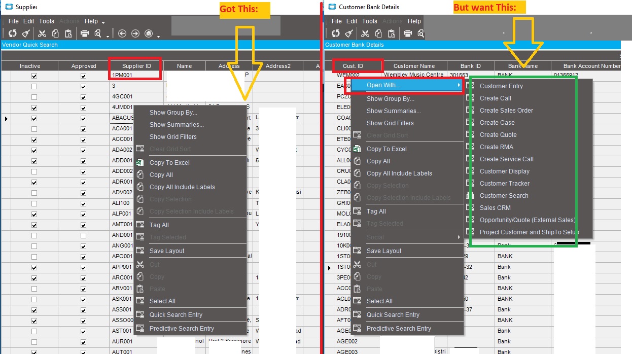

I’ve created a dashboard (Nothing more than one BAQ really - no trackers, filters etc.) for our Suppliers.
I want users to be able to right click on ‘VendorID’ and ‘Open With’ Supplier Entry or other relevant options.
But right clicking only gives the option to copy to Excel etc.
In other dashboards I’ve made, we can right click on a field, e.g. CustID and ‘Open With’ customer relevant forms,.
What have I missed please?!

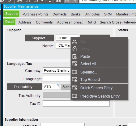

Yes, @Hogardy, I was wondering the same thing, what Table.FieldName are you using for Supplier ID? If you go directly to the Supplier Entry form can you right-click the Supplier ID field and see the Context Menu that you are looking for?

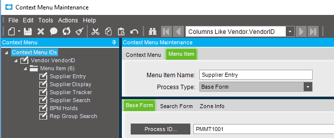

This is what is showing up in my Content Menu Maintenance for Vendor.VendorID:
Do you see anything similar?

What if you open the Supplier Entry Form itself, can you right click in the VendorID field and see the appropriate Context Menu?

Good point - no I can’t!

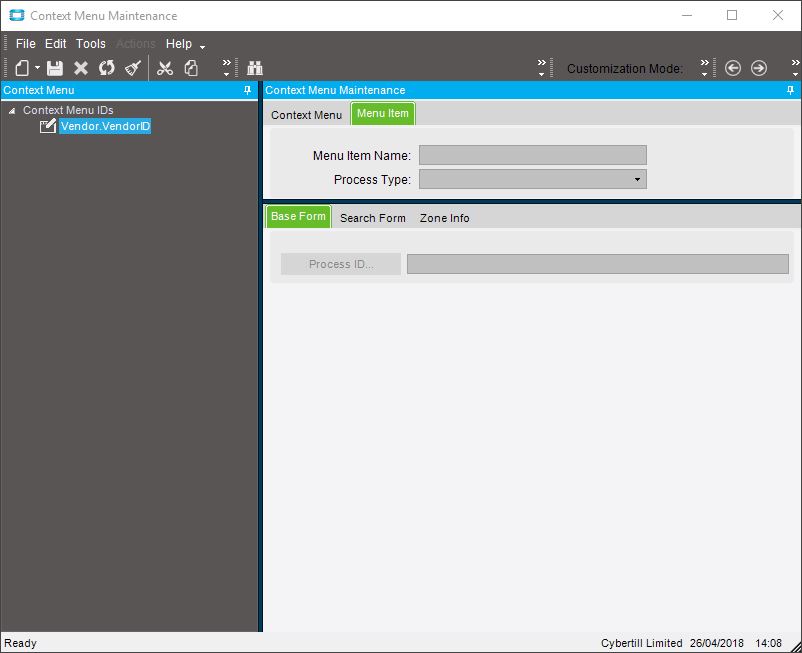

Right I’m looking at Context Menu Maintenance now - thank you so much!

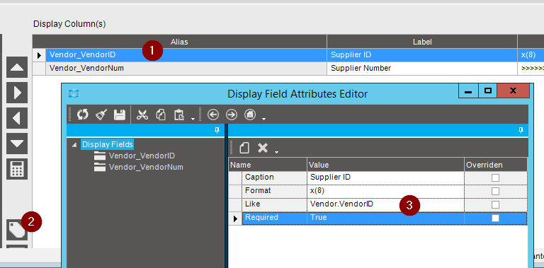

One way to always make sure that the field is right clickable is to link whatever table you are using back to the primary table (in this case, Supplier) and display the supplier ID from that table… then the right click will work…
BUT there is also a simple workaround. Sometimes there is a field (from a UD Table for example) that you want to “act like” another field… in this case, you simply need to tell the BAQ what to do.
  1. edit your BAQ, and click on the display column
  2. click on the Display Fields Attributes editor button
  3. examine the “Like” attribute value… if there isn’t one, then click the add button, and add the Like attribute and manually type in the correct field like value… in this case “Like” “Vendor.VendorID”

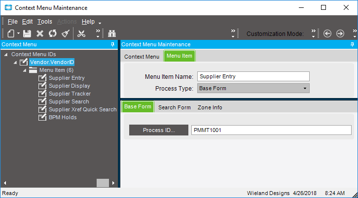

Hmmm… Karen, it looks like you have no menu items associated with the VendorID field. Here’s mine (E10.2):
Since the context menu is user specific, either your entries have all been removed, or a ‘global’ customization mode removal occurred.
In any case, to view a context menu, you’ll have to add the entries you want to see.
