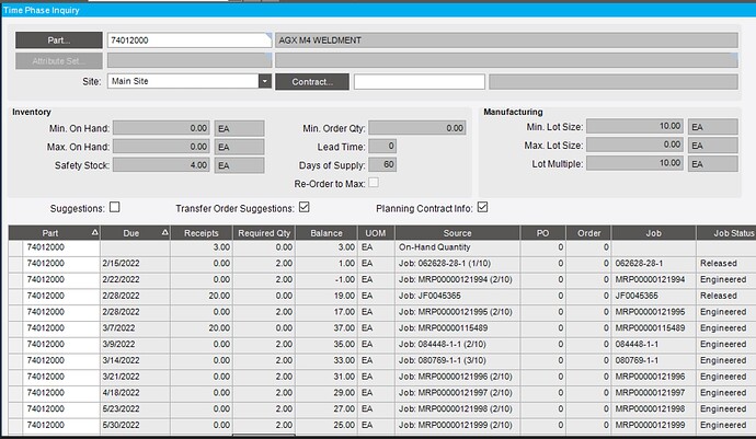

There should be a way to tell MRP to relax a little… just a little.
Kind of like the Reschedule Out and In fields for PO Change Suggestions.
So here is my situation. I have 3 of part X on hand.
There is demand in the near future for 4.
I have a released job due just after the demand.
MRP sees that there is more demand than supply and that the job won’t get done in time. So it kicks out another job for the a whole production run. And based on the Receive Time on the part the MRP job won’t get done until after the job we already have released.
Now if that isn’t bad enough, that “bonus” job that MRP made is kicking out New PO Suggestions to Purchasing for the whole MOQ on the raw materials.
Our shop floor managers have to research every MRP job they see. They don’t feel like they can trust anything.
Worse, our Buyers have to research every PO Suggestion they get. They don’t feel like they can trust anything.
Is there some kind of feature we could use that would make MRP jobs look forward “X” number of days to see if we are going to be OK before it kicks out an MRP job.
All of that functionality already exists in Epicor. I would recommend getting a consultant in who knows planning inside and out to help. Changing some of the fences and other options should fix it.
I would look for an APICS consultant or something similar. The person does not need to know Epicor, just someone who really understands MRP, Planning, Scheduling, etc.
