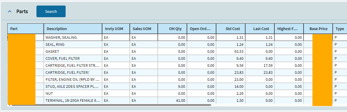

One might argue that is correct. If you are standard, that’s the only thing that matters. For that Cost ID/Plant, Last (and Average) are calculated only when something is received, and nothing has been received yet.
Do the missing parts not have a Site/Part relationship?

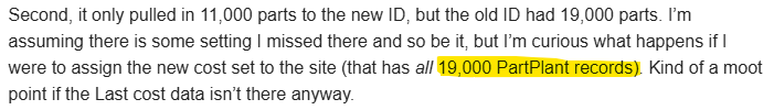

This was 2 years ago, so I can’t guarantee what I researched. But this statement makes it sound like I was comparing [number of rows in PartPlant for MfgSys site] to [number of rows in PartCost for the new CostID]. And they were 3,000 apart (well 8,000 at first).
But doesn’t zero mean, “You haven’t received any at this site yet, so there isn’t an average/last/lot cost.”? :person_shrugging: All of these costs are not updated with buy direct either.
Now, last PURCHASED price is an entirely different thing, and yes we do want to know what that is.

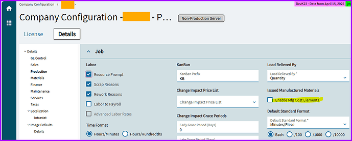

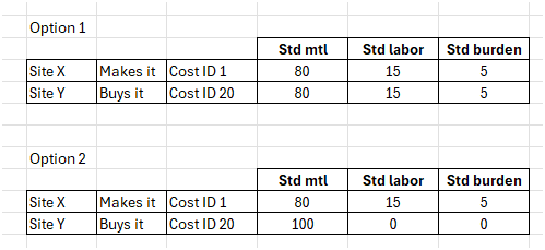

This involves settings that I have not touched in a few years, but…
First, it sounds like you have a std. labor and std. burden as part of the standard in cost ID 20.
Is yours like option 1?
There’s probably an argument for option 1 or option 2.
Option 2 would seem to solve your problem.
But you can still stick with option 1. In that case, you’d probably want to uncheck this setting, “Enable Mfg Cost Elements,” in the Company Configuration. This will roll the cost of the part as all material into a job it gets issued to.
Now, that’s for jobs - if you ship the part, then it would stay in the “buckets” of material labor and burden when going to cost of sales.
Also, it’s a company-wide setting! So you have to live with it everywhere! That is, unless you get creative and have a BPM toggle the parallel setting on every job. A user did that at some point here.
Ah here that is:
And no, is the answer to this.
