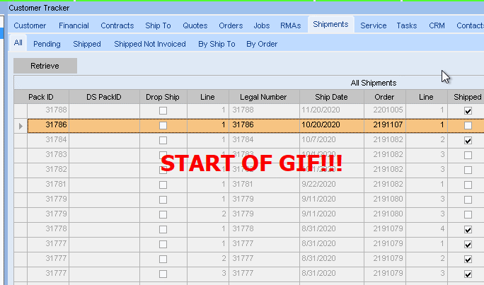

One warning on using the Right Click -> Open With …
If the value in the source field (where you right clicked) changes, the record loaded in the window that was opened (like Part Tran History) will change to match the record in the source window.
This can you throw you off if you open a window with the right click, then go back to the first window to look at something else, and then go back to the second window thinking the info is still related to the initial right click.
In the example below I 'm in Customer Tracker, and looking at the shipments. I right click in the OrderNum and use open with Order tracker. It opens that window and loads that order. I go back to the Customer tracker and select a different row, and now the Order Tracker is showing a different record. This can be handy for having the second window follow you like a lost puppy. But if you forget, it is easy to look back at the second window, and think its the first record you opened it with.
Right-Click
