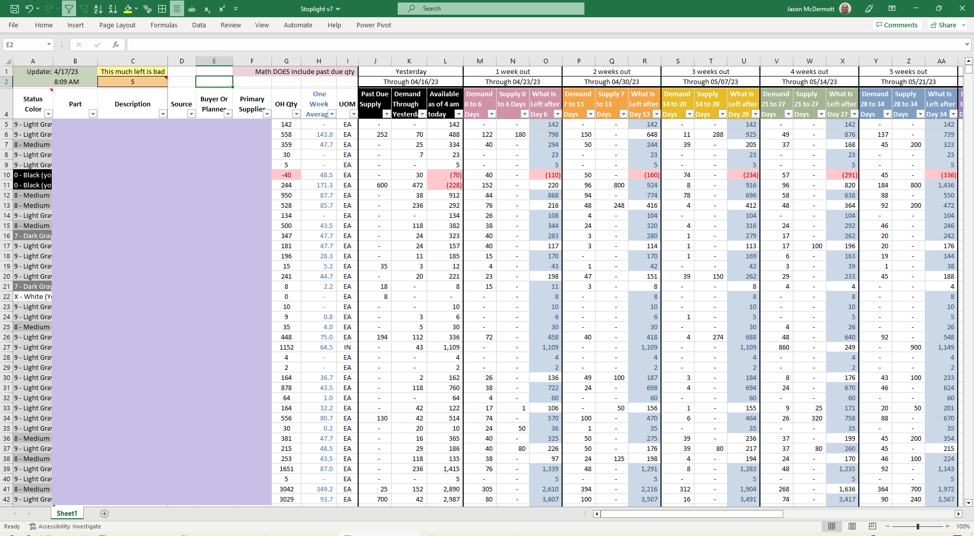

We developed a BAQ/dashboard/Excel sheet that summarizes millions of PartDtl rows into a single report. I love this thing.
I’ve revised it since this, but it looks like this:
Edit: Here it is today (well, Monday):
They asked me to add a column for average weekly usage and then turn cells blue if we have more than X times that on hand at any given time.
We apparently always have too much inventory… Thanks, covid.
