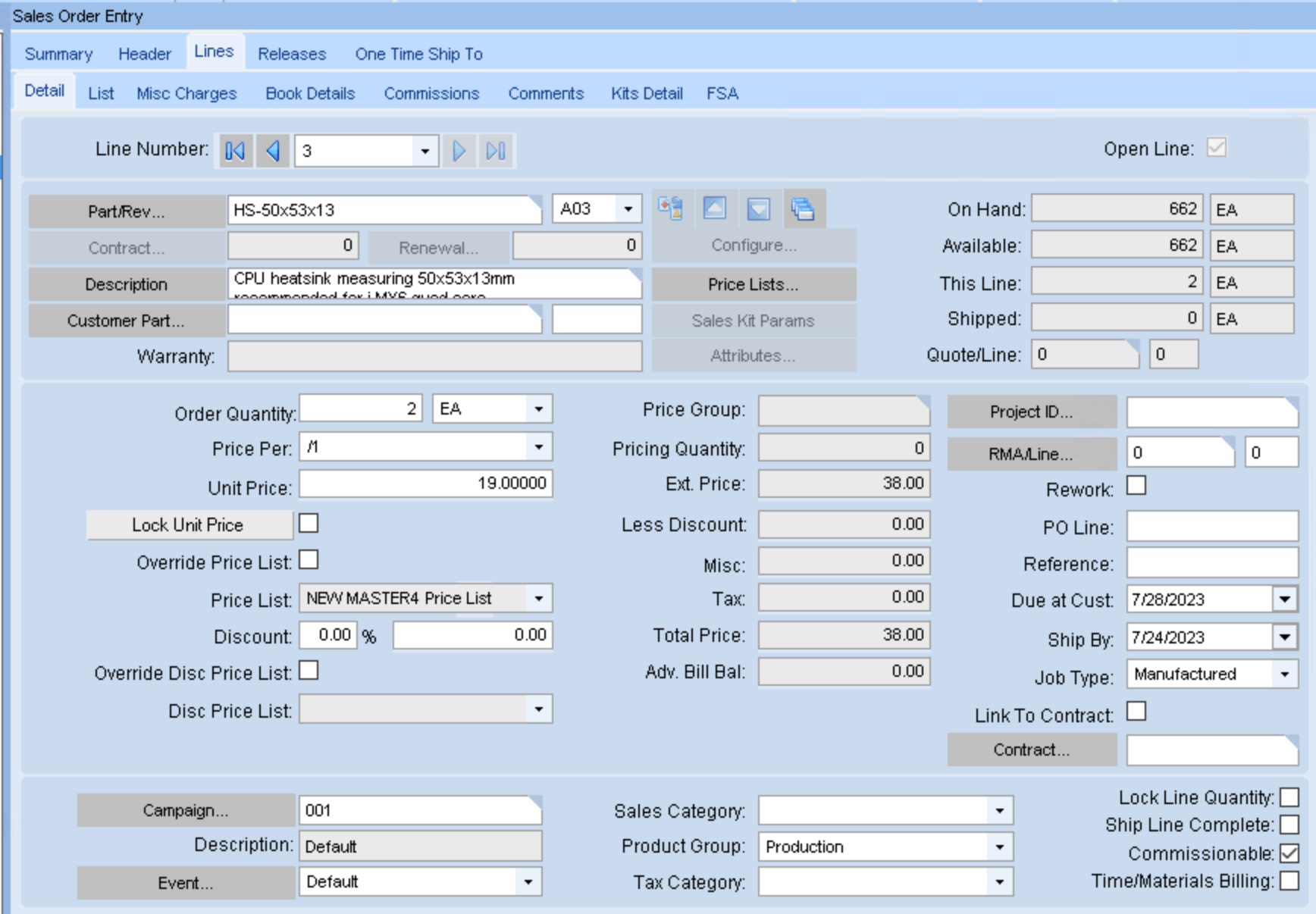

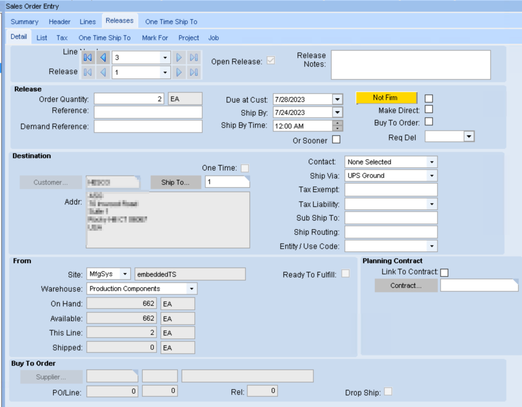

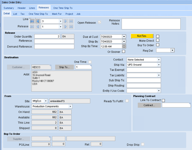

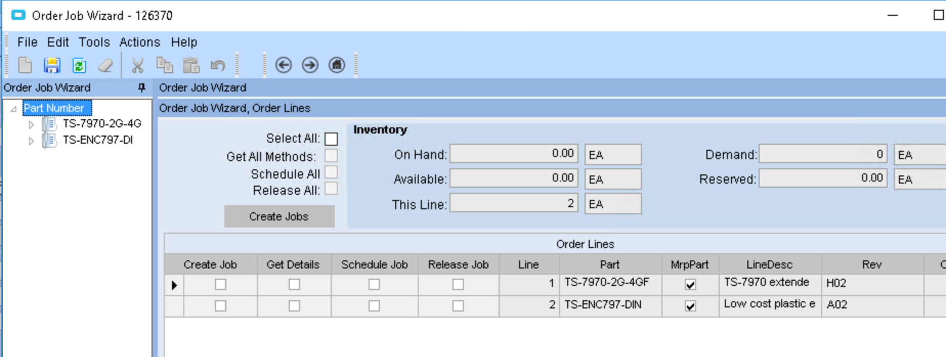

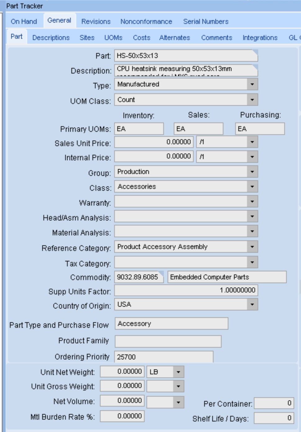

@timshuwy No luck, below are some screenshots of the order detail, and the part to show it is manufactured, as well as order job wizard showing it’s not giving the option to create a job.

Release detail has dates:
Line detail has dates:
Part is manufactured:
Order Wizard doesn’t give option to create a job:
TypeCode is present in the PartPlant record as well. When you change a K to M, be sure to check the records under the Site tab as well, to make sure the K has gone down to that level. Sometimes Epicor shows a confirmation box and copies parent field values down to child records, but it pays to check.
I thought order job wizard was only for make-direct? In your screenshot the release isn’t marked make direct.
you need to check the make direct flag on the release. The system believes that this is normally a stocked item (based on the settings in the part). because of that, it will not show as a job to be made. if you click the make direct, it should also say “override” because it is normally stocked, but then you should see it in the order job wizard.
OH… and also, you dont have this marked as “FIRM” on the release. you should do that as well, otherwise, even MRP will skip this release.
