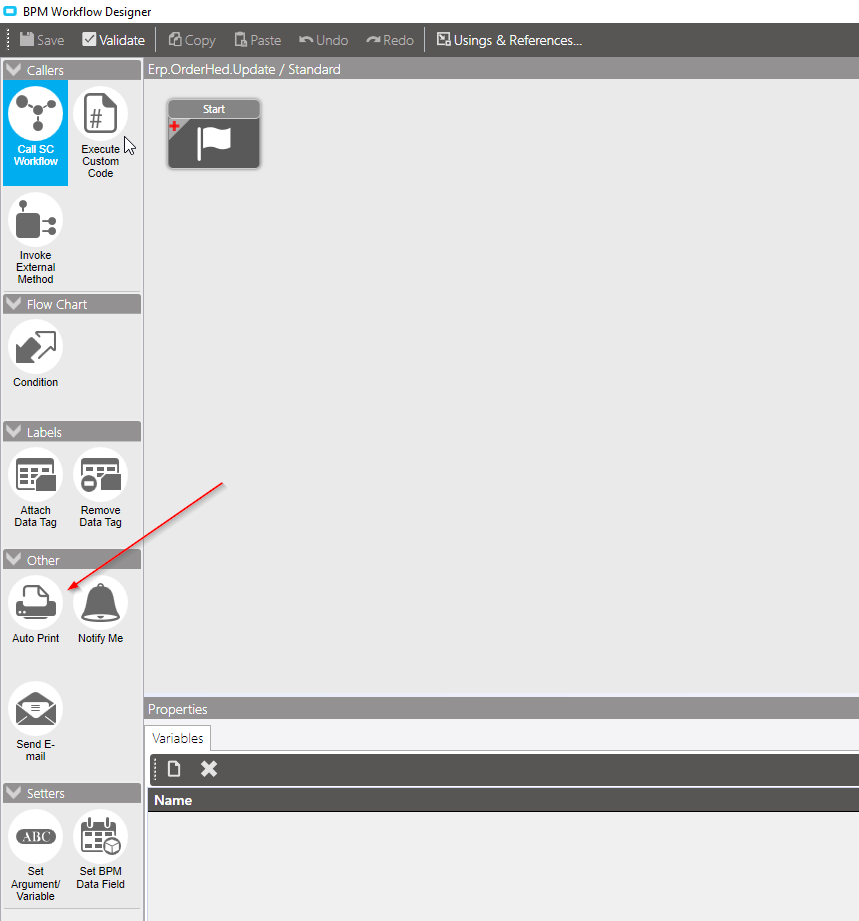

There is an “auto print Ready” checkbox on the Order Header. We use that for printing and emailing Order Acknowledgements.
Vinay Kamboj
Vinay - Thanks! I never noticed that.

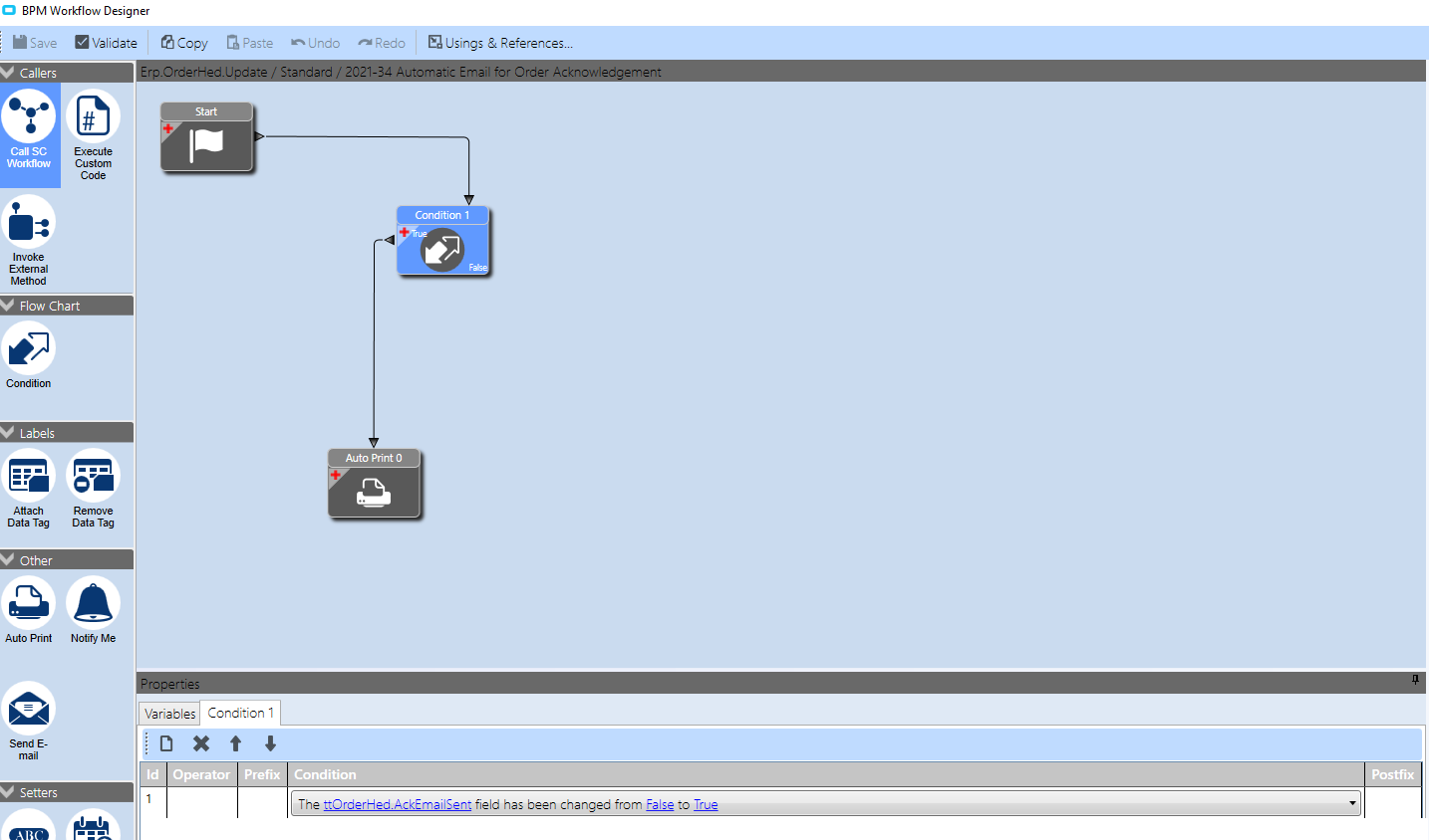

Here are the two BPMs we use - should work for API…
