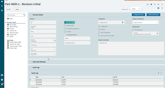

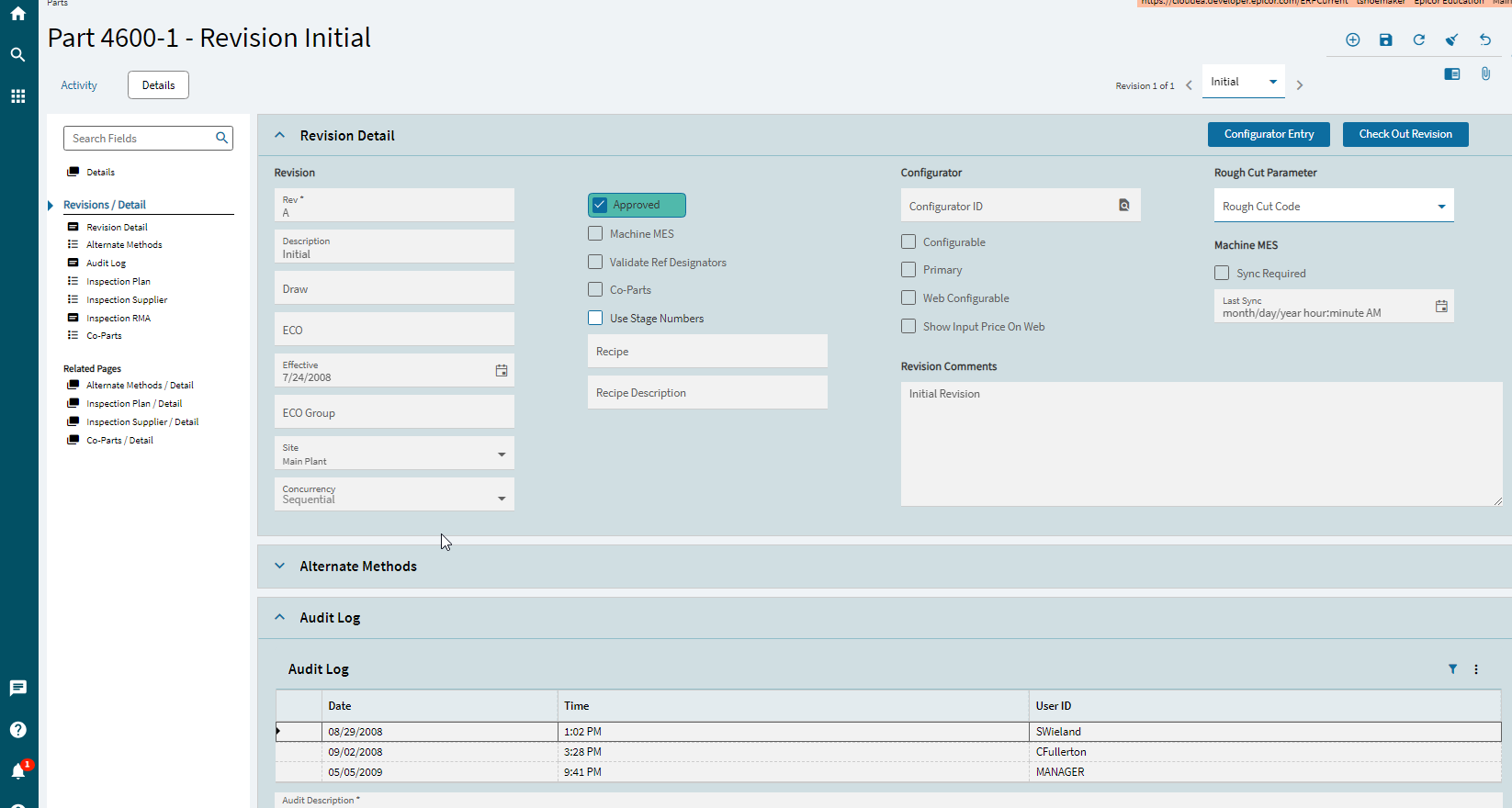

The best way is to use the built in screen on the part table… when you go to the revisions, you can see the “audit Log” which shows the history of each time a revision was checked in. This is available in both the browser and smart client versions going way back into the dark ages of time.
This is a functionality (now that you’ve pointed it out) that I remember using in Vantage 8 , but had forgotten about since I haven’t used it since then.
There are all kinds of these little-used features that don’t have good press agents… although they’re documented (in that they have help screens and such), they aren’t really encouraged (in that if you don’t know they’re there, they don’t jump out at you).
This is not a rant, but all these little gems are hiding there in plain sight.
