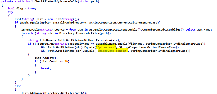

Basically AutoUpdate does 50-100 random tests of files checking if the file can be deleted.
Their code has a line to exclude Epicor.exe from this test and since your new Assembly name is Kinetic.exe it will “possibly” try to check if Kinetic.exe (but not always true - it sorts it alphabetical so it depends if your exe gets caught in the 50 picked) can be deleted (which is in use). If any of the 50 files comes back as “not-deletable” it assumes that Admin privs are required.
The test it performs is
File.Copy(file, tempFile);
IOHelper.DeleteFile(file);
File.Move(tempFile, file);

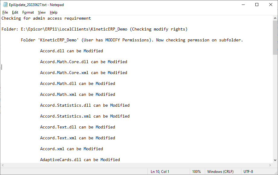

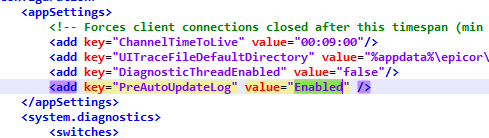

You could add to your Epicor.exe.config or Kinetic.exe.config the following which will cause AutoUpdate to write a log with more information on which file is causing trouble.
it should write to your Temp directory an EpiUpdate file

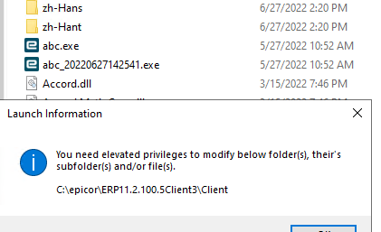

You can replicate the same thing by naming your assembly abc.exe post-install while having Local Admin, then forcing an update.

Wow thanks @hkeric.wci! I did not think the name of the executable would make a difference. The 11.2.100 installer creates shortcuts to Kinetic.exe. Changing the shortcuts to point to Epicor.exe appears to resolve the issue but hopefully Epicor can patch this instead of me having to create a hack. Out of curiousity, which file contains the CheckFileModifyAccessOnDir function? It seems like patching that file to include Kinetic.exe and Kinetic.exe.config resolves the issue
AutoUpdate.exe
