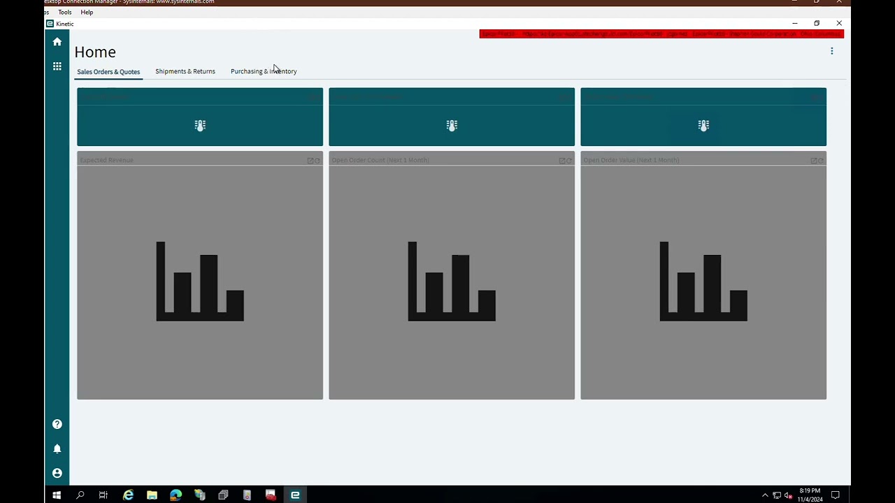

This is the first time we are deploying the Kinetic HomePage to everyone, so far it hasn’t been an issue. We were able to create layouts for all the major functions ahead of time and assigned them to each user via DMT (that was nice)
Finally were able to replicate #7 above, case opened PRB a coming
Demo Below: 500+ Angry user’s with pitchforks yesterday. :zipper_mouth_face:

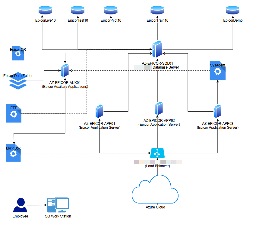

Interested in that architecture is that 13 app servers for Production or 13 app servers across the board and if 13 app servers for production are you running multiple appserver (application pools/website) on the same host?
Eg.
HOST1 ---- ProdAppServer01
      ---- ProdAppServer02
HOST2 ----Prod AppServer03
      ---- ProdAppServer04
3 physical servers for production one app server each in one load balancer
We have 13 app servers across the organization for development training pilot and testing (and 13 databases)

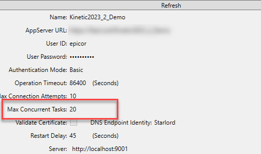

Only one Task agent? What settings, just the default? Sorry if getting a bit too in depth @Haso do you recall what you had used in past.
I was curious about the Max Concurrent tasks setting value. What value do you have that set at?
We have 2 Agents running on different servers.
Max Concurrent Tasks setting value??
Whatever is default
That would be 20… Thanks for all the clarification

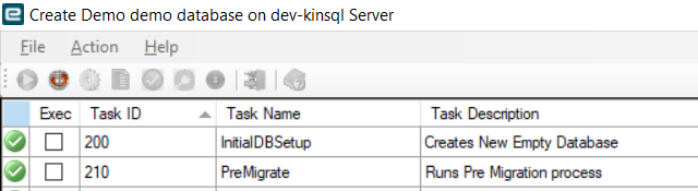

@josecgomez do you have to run the whole thing? I notice the Ice Common DB gets created in task 200:
